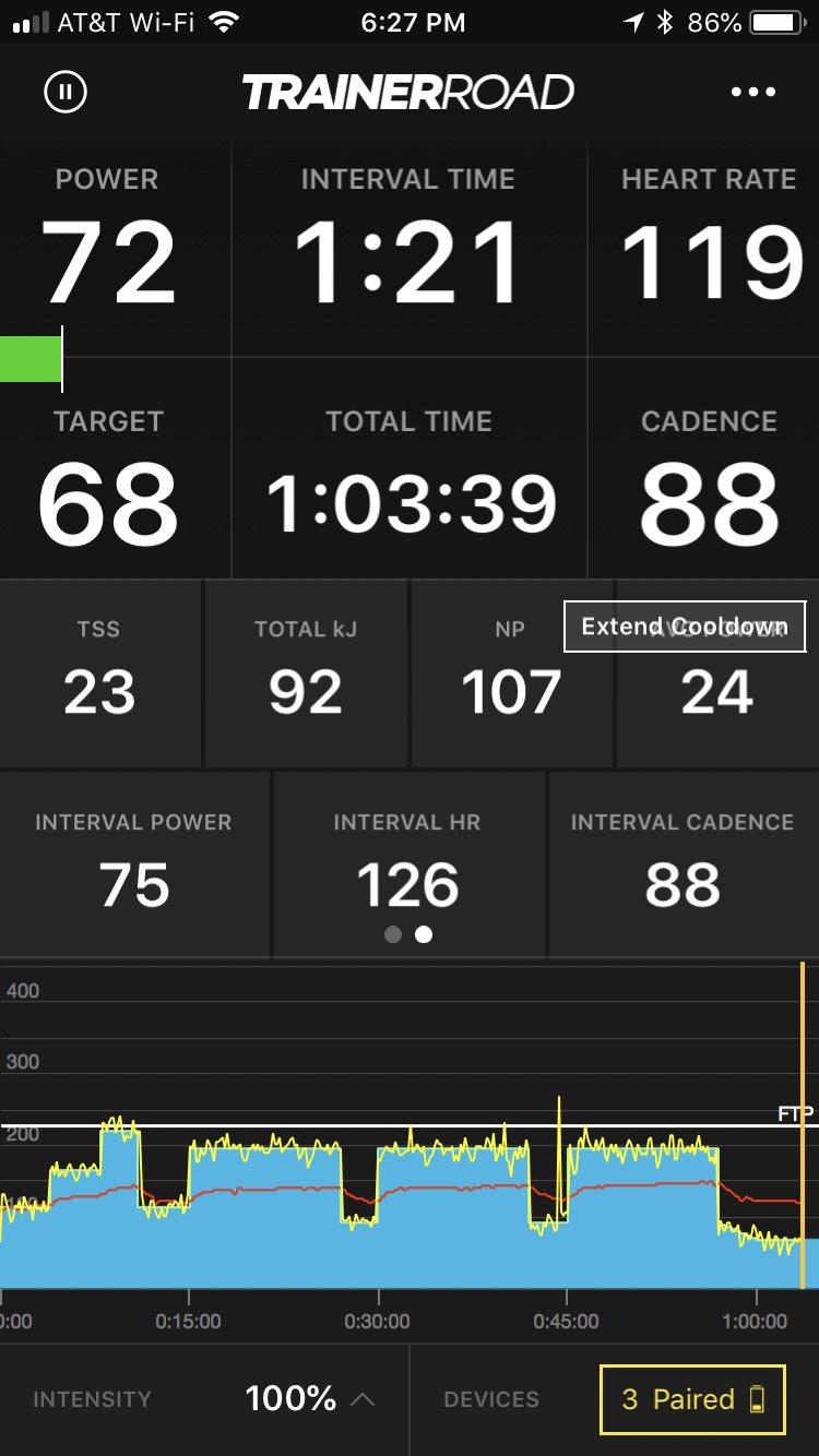

It is a bug, I reported it months ago. First time was on July 1 and it dropped 8 points right after I +5 min extended the workout. It happened other times too, but I never captured a screenshot. On Aug 29th I finally captured screenshots - entered the cool down of Mount Field and TSS was approximately 60, then it dropped to 23 (yes, it dropped 37 points) and I captured screenshots. A few minutes later the workout ended with a TSS of 64.
Only seen it happen when I’ve added +5 min to a cooldown - either because that triggers it, or its the only time I pay close attention to TSS during the workout.
I can’t say for certain whether or not my experience was during an added cool down or not, but it definitely only dropped a point or two. I wouldn’t say mine was a bug based on that, but your experience does sound… interesting.
I’ve also seen it drop a point or two.
But this one is pretty obvious:
Mount Field has a 60 minute TSS of 62. And here is post workout:
