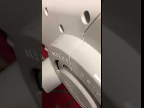

I have a new Drivo. When I am running in ERG Mode, it appears that my traininer is constantly adjusting and I can feeling and high an audible adjustment from the trainer. While everything appears to function correctly, this constant adjustment sound and feel is a bit aggrevating. I can turn off the ERG mode in the Trainer Road app and the issue goes away.
Has anyone experienced this? I am curious if it is an incorrect setting on my part or possible a faulty data feed from my device (macbook pro).

Typically when you plug the trainer in the servo that controls the magnet moves. Does it make the same noise you’re hearing when riding in erg mode?
I hear it upon power up/ power down and through the workout when ERG is turned on.
You can here the mild ‘thump’ of the ERG in the back ground
