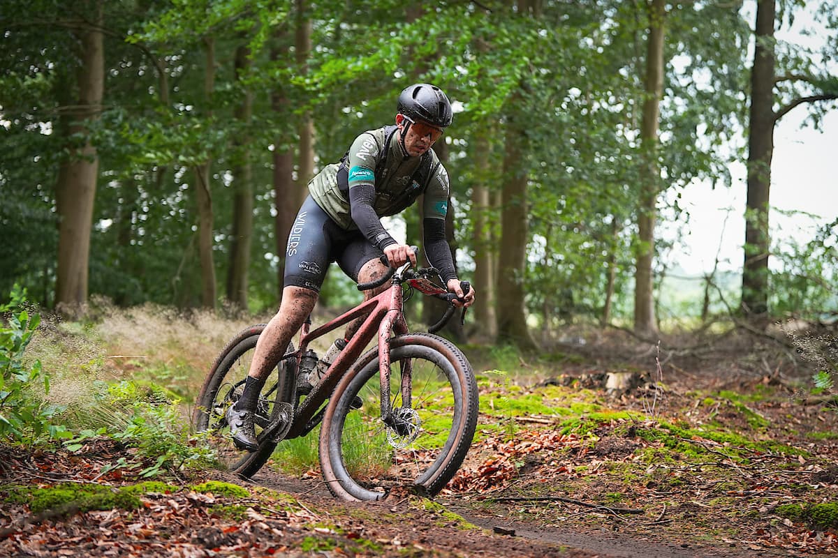

What frame are you working with? Would love to see your set up!
It’s a 2018 or 19 Trek Procaliber SL
Sorry for the shitty picture…
