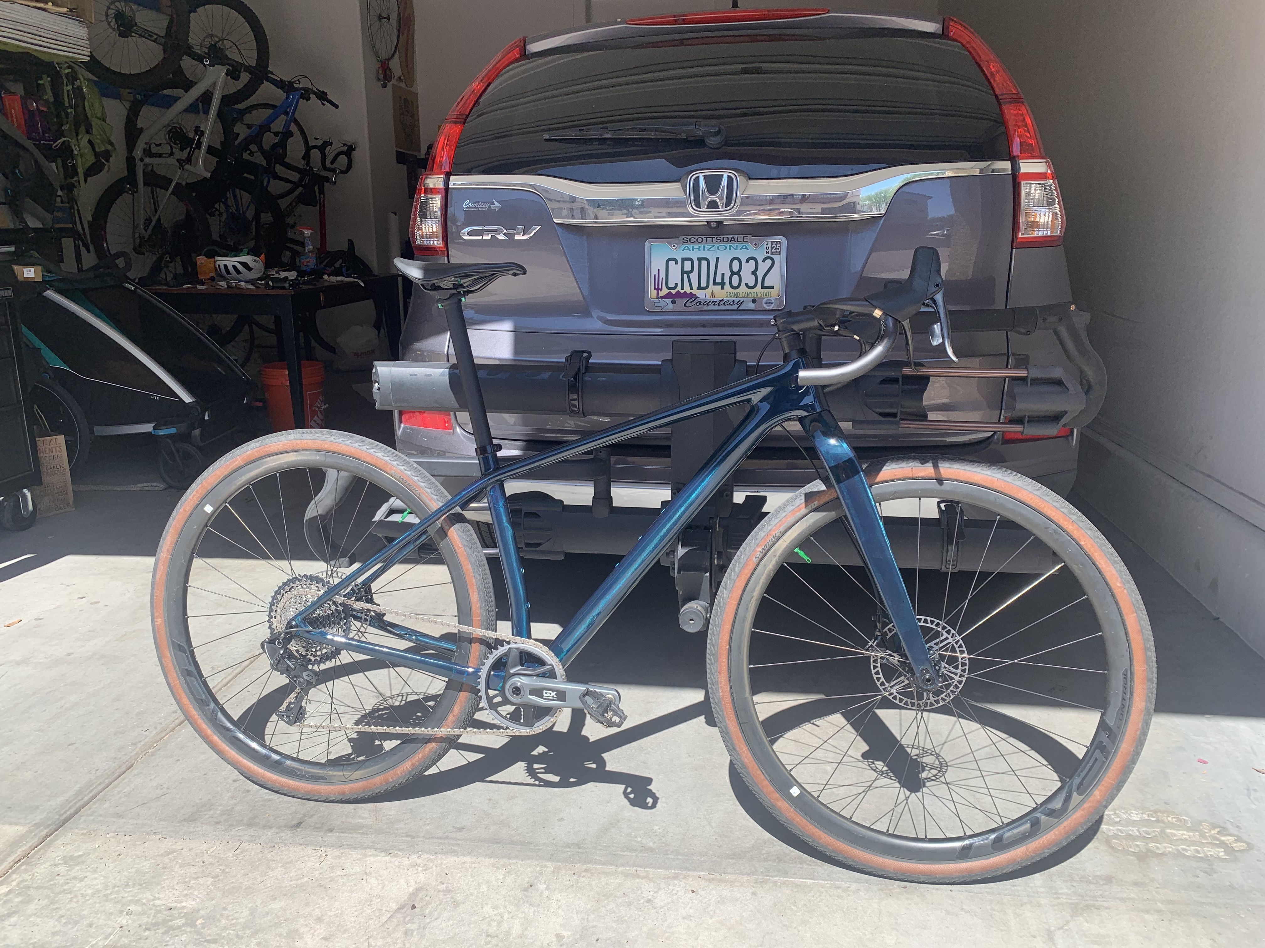

Some thoughts thus far:
This bike is LONG. Reach of like 455mm. I’m usually on a size 56.
Maybe it’s been a while since I’ve been riding gravel, but I’m struggling with the reach of the bike despite coming down from my first attempt of 80 to 70 and now 60 mm stem. Moving the saddle forward to compensate half an inch has helped, but I feel the compromise on my stroke and freshness of my quads on longer rides. Currently, the effective system reach is shorter than my road bike…
Handling is great, I feel like I’m able to weight the front wheel properly, and the slack head angle helps me descend with confidence. I’m sitting at about a 70.5 HTA. Bars are 40cm with 58cm swept/flared drops.
Putting on the Raceking 2.2s increased the trail figure and improved the overall feel of the bike, more stable and less twitchy than when it had the 42 mm S Works Pathfinder tires.
Overall, I like it, But I am finding that it is a lot of bike for leaving from my backyard and riding canal paths, and unpaved desert trails. The chunky trails I did try were not drastically easier. Much easier to descend, equally difficult to climb. Haven’t weighed it, but it’s def lighter than my Carbonda 696 gravel set up!
I think my next move will be to put on the suspension fork and see how that effects things. It is slowly moving away from a “fast” gravel bike, which is ultimately what I want to end up with. Hmm. Will be giving it plenty more rides before I make a decision on selling the frame set or making it my dedicated gravel bike.

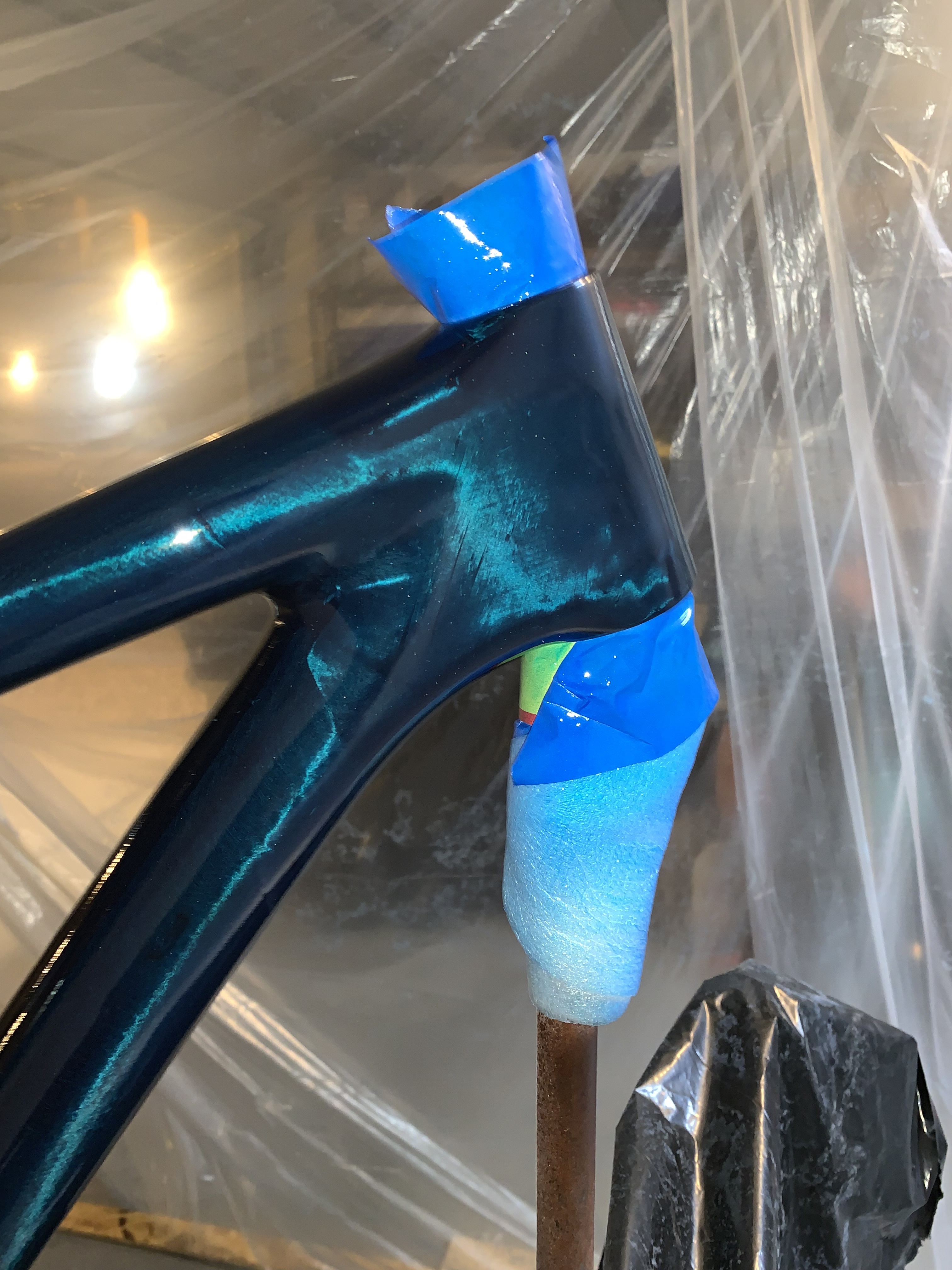

I’ve already put the effort into the paint job :sweat_smile:
Sorry, this is a long post.
TL;DR; I love this drop bar MTB!

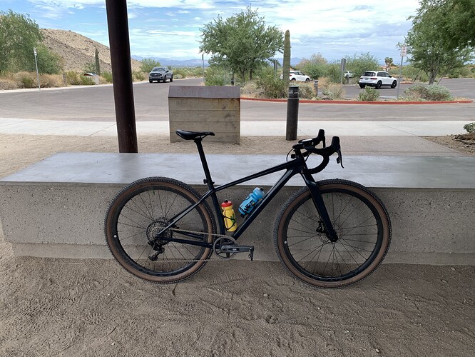

I completed my build in February (post above). Since then, I’ve ridden it for about 2000km (1250mi). This has been 50% commuting, the other 50% gravel and mellow MTB riding.
I adapted pretty quickly to the position, yes it’s quite long, but not uncomfortably so. After riding it a lot, I’m actually more comfortable on this bike than on my road bike. The bike is a Large Airwolf YFM026 (SC Highball clone). I put on a rigid fork (also Airwolf) with an A-C length of 480mm. This made the reach of the bike 465mm, with a 71° HA and 74.4° SA. I settled on a 70mm / -7° stem, combined with a handlebar with short reach (70mm). And I slammed the seat almost all the way forward, which is the case on all my bikes, not just this one.
I love the way this bike rides, very stable and fast, even on singletrack! At the moment, I have 2.35" Thunder Burts mounted on 30mm IW Nextie rims. Very fast, and more than enough grip when things are dry. But they wear out pretty quickly. So I’m gonna try 2.2" Race Kings next. And in winter, I’ll put on 2.35" slicks for beach racing.
Stuff I don’t like about the bike is the groupset on it. I tried to save some money with a LTwoo gravel groupset (mechanical). Which works fine for commuting, but on gravel or MTB roads, with lots of shifting, it’s just way too slow, or doesn’t shift at all under small load (<200W). So I’m thinking about changing the groupset. I really want to keep the Shimano calipers. Just change up the shifters and derailleur. So GRX 12 speed?
@Upcountry How is the GRX/105 Di2 combo holding up?
Some pictures from a recent race I did: It was a flat 200km “MTB” race with this bike. It’s actually quite mellow terrain with flowing singletrack. But the rain of the last months turned the race into a mudfest.
(Note, my brother has the same bike. He just chose to build it as a rigid flat bar MTB)

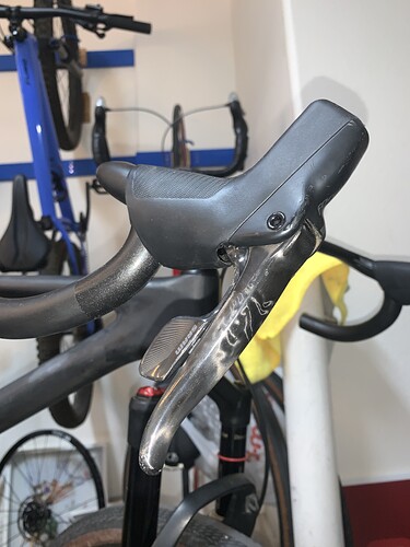

I liked the Ltwoo shifter style but their rear derailleur was terrible. It’s one the same pull as Shimano 11 speed so I swapped it for a Sride 520c and then the system worked much better. Swapping it for a GRX would improve things too and if you’re still not impressed then you can switch the levers later.

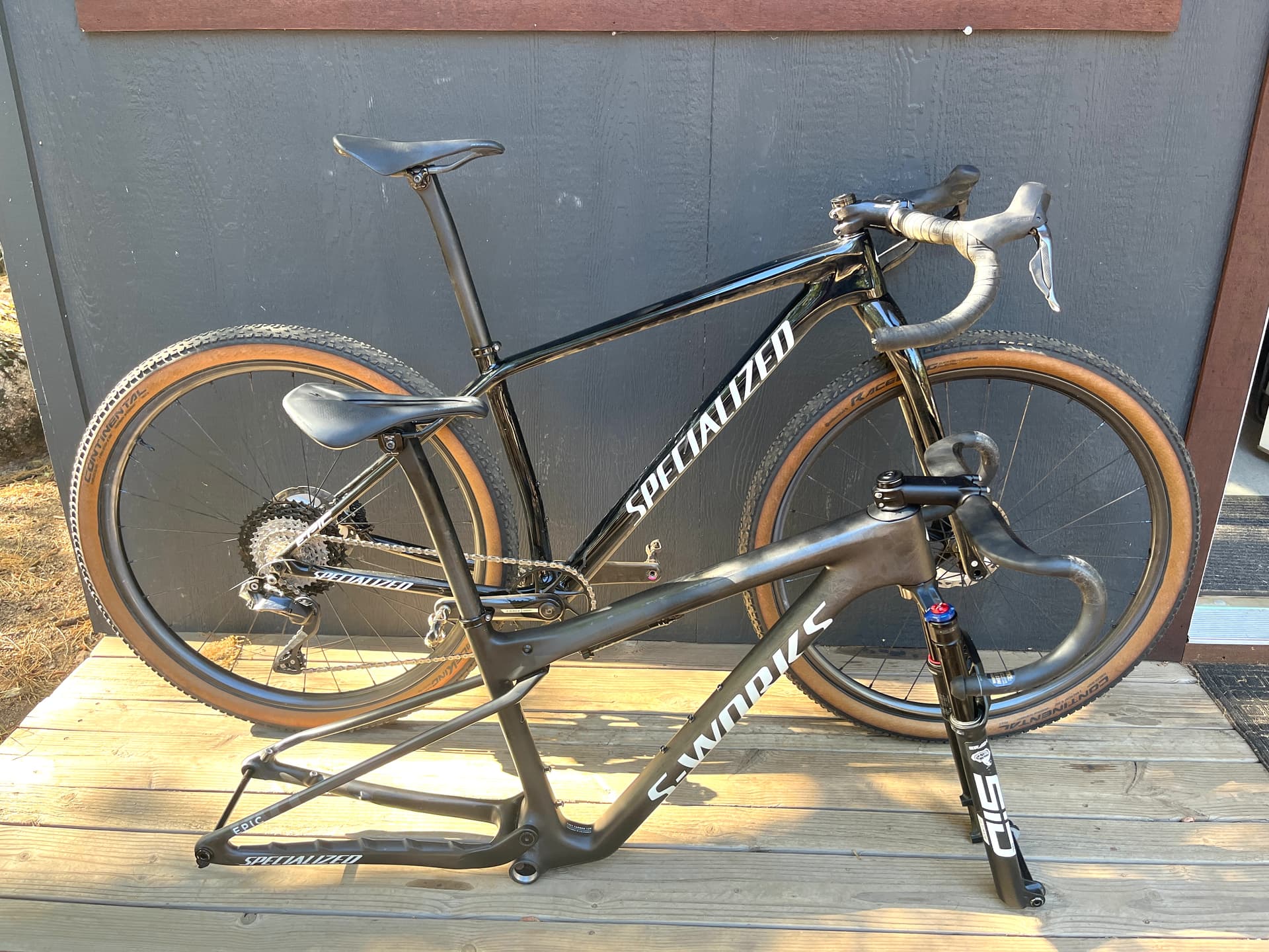

I didn’t really have anything negative to say about my Epic HT build. The geometry takes a ride or two to get used to, but its not like there is anything natural about riding a bike, so they all take a bit of time. I’d been spending quite a bit of time on my Epic Evo leading up to my last race, and with another one in August. The more time I spent on it, the more I disliked riding my Crux(for sale) or the Epic HT(for sale). While tires do give some cushion, there is a substantial difference, and I do think suspension can be a worthy addition, if not for speed alone, simply for the enjoyment of the actual ride itself. Thats not to say that everyone needs suspension on their “gravel bike”, but for “my gravel”, its pretty easy to justify. Its also worth mentioning, I’m not doing your typical 100 mile full gas gravel races any longer, so the stereotypical “gravel race bike” is no longer what I want.
I got everything swapped over from the HT to the WC yesterday, but haven’t ridden it other than around the property. Rather than trying to mimic the Crux geometry, as I initially did on the HT, I kind of just went by feel, while knowing that I’d end up higher up front than typical, and so the added reach wouldn’t be as much of a negative. Setup with a Syntace Flatforce 77mm stem currently and it feels pretty right, but time will tell. Specialized gets crap for dozens of reasons, but man their bikes build up really easy… Brake mounts are true, internal routing paths smooth, etc.
Total weight here as shown with pedals, cages, and power meter is 21.55lbs. So three pounds heavier than the HT, with the identical build kit, but honestly I’ve largely quit worrying about weight off-road(within reason).

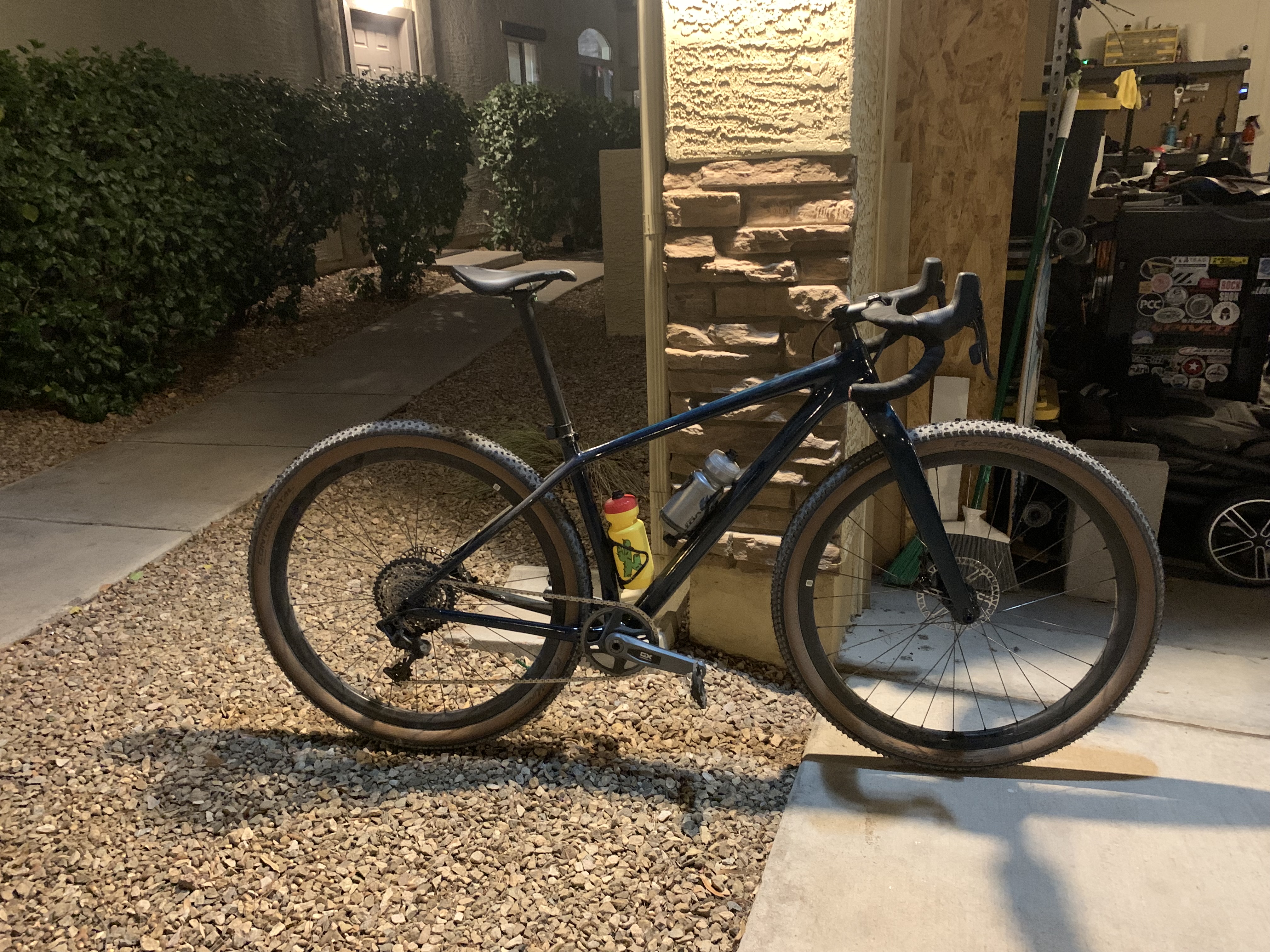

Y’all, this set up is the TICKET.
I went over bumpy single track. A rocky, rooty trail. Torn up pavement. Not a problem! This SID 100mm ate it all up. I am running suspension with about 25% sag, and I was just floating over everything. The reach is also much more manageable than how dropped down it was rigid. I’m really loving the set up, I was worried about the 42 mm offset of the fork but that hasn’t been an issue thus far.
Yeah, I actually like the Campy style shifters. And the braking is also fine with the shimano calipers (for the use case of this bike)
I have the 12-speed GRT group, so I don’t think there is a direct swap possible? Or is the pull ratio the same for LTwoo 12-speed and Shimano GRX 12-speed aswell?
The pull ratio is the same between GRX and the LTWOO GR, so I’d expect that carries to the 12 speed versions of each. But I haven’t tried that combo in 12 speed, only 11.
It took about ten minutes for the verdict to come in… This is the winning ticket.
I have zero hesitation in saying that this bike is faster over my local gravel/dirt roads than any of the other bikes I’ve owned.
The traction out of the saddle pushing up little pitches at 600 watts is insane. The ability to stay seated and pedal through ruts and over washboard is very easily worth the couple pounds of extra weight. Leaning into loose corners at 20mph feels super stable, and planted. Typically on the standard forest roads on a gravel bike I find myself hopping from the outside line to the apex, and then back to the outside line, and hoping that the middle line isn’t too loose. With the added traction of wider tires and the suspension working, its really reassuring, and lets you push deeper into that corner with more speed. Brain forks get a ton of flak from what I’ve read out there, and this is my first experience on one, so I don’t have a depth of experiences with them, but I do really appreciate that I can just set the “Brain Fade” to one position, and let it do its thing. Same goes for the rear end; as there is obviously no “lockout” but it doesn’t feel needed, even when I was hammering up the paved climb to start my ride. And as a result, there isn’t a need to reach down and change anything after certain sectors of road/gravel/trail. I could see the downsides on a true XC bike, but for this use case, it seems truly ideal. Obviously this is a pretty niche build, and haters will hate, but if you’ve gotten this far in this thread, you’re likely a little more adventurous than most…
I’m right there with you… I was avoiding the suspension fork, and probably got too hung up on “matching” my other bike fits. While the result was totally acceptable, I’m really happy with the bit higher front end, and the extra couple pounds is insignificant.
I’d be way open for something like an 80mm travel fork, but can’t see rushing to change anything on my setup now.
From what I understand, it’s a matter of swapping out the air shaft to a 32mm stanchion 80mm travel shaft. Like 40 bucks retail.
It would afford you more of a 480 AtoC fork length. Even steeper at sag.
I’m curious of your Brain fade settings, I went slightly towards the open side from the middle. And then went like 15% sag.
I think i’ll be trying much more firm and then 25% sag. AKA less pressure.
I’m currently running 75 psi at 170 lbs.
