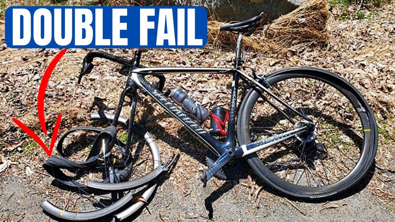

Edit: it is worth noting that you may argue that failure of the brake track for 1 complete full stop from an extremely high speed is actually a feature. Look at the tests for one of the wheel manufacturers that showed their brake tracks not failing at high speeds when brakes are applied; the brake track basically became useless due to the pad/carbon glazing and as a result, you see the wheels never fail under load… because they are generating low amounts of heat… because the coefficient of friction is so poor and you are going full speed. Failure of the brake track for a safe complete stop technically means the wheels worked to stop the rider. Something to consider, as if you evaluate a wheel for “structural survivability” alone, I can guarantee that you will stop… just not likely how you want to.
