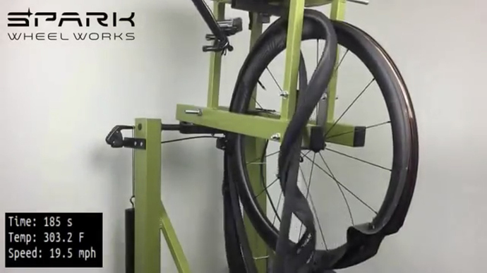

Watch this video to see the death of some rims. Would be interesting to see disc brakes in a similar test.
After watching this, I might have a little anxiety about relying on rim brakes + carbon wheels for long mountain descents :confounded:
Ouch!!
I like rim breaks better because they are simpler to find the right wheels for, no thru axles. though you could run 650 on a disk bike, it just dosent make enough sense when finding a thru axle that fits your bike, if the were all standardized and the disk beak rotor mounting system were standardized so that you can just move any disk wheels that the frame has enough clearance for to any other frame and setup w/ disk with no compatibility issues. disk would also need to get to the same weight as rim and be just as aero. then I would make the switch
When was the last time you rode the brakes for 5+ minutes while going 19+ mph the whole time. Interesting but not very applicable for day-to-day applications. Yes, YMMV.
Yeah - it’s a little (or more!) artificial. Although when I rode triple bypass this year, I smelled hot brake pads / rims from riders in front of me on a number of occasions (E.g. at the bottom of long bike-path descents where all the riders bunch up at a turn). I had never experienced that before.
