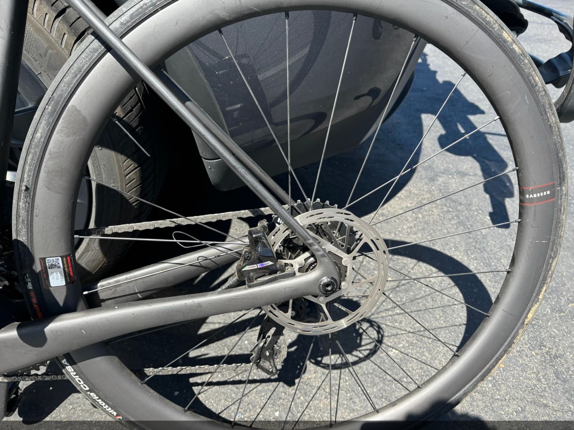

and last month, a friend that moved to SoCal:
which turned into
10th this spring…
:cry:
But hey, if you never flat more power to ya!
