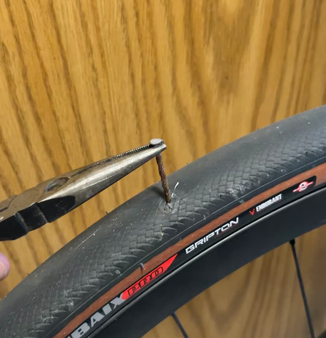

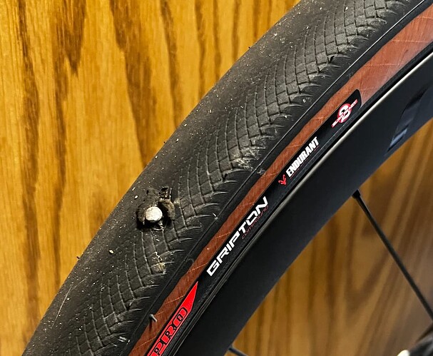

I’ve got more nail than screw pics LOL, and more goat head & tiny needle (from radial tires) pics than nail/screw pics.

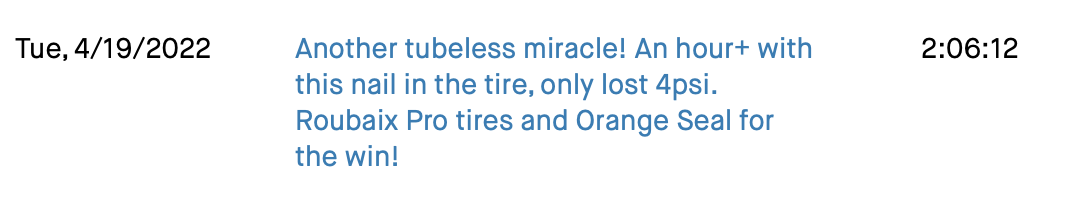

Older post, 20 “tubeless miracle” punctures that didn’t stop me over 2000 miles…
EVERYONE around here on tubes gets flats. Not uncommon to get 2 flats in one ride, not saying its common, just saying it happens and I see it on Strava every 3-5 months or so.
Almost everyone I know rides outside and not much on the trainer, all 365 days of the year. Some Zwift/Rouvy/TR/MyWoosh rides in the feed, but not many.
Small price to pay for generally great weather and cycling friendly roads.
Tubeless you (usually) keep on trucking.
