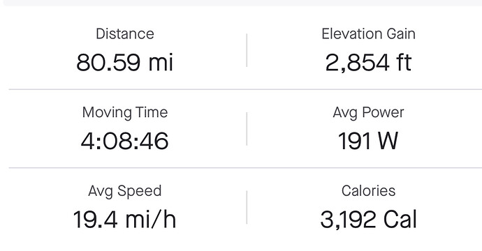

We have the same ftp. I can hold 190w for four hours with no drift. You can too! And look how many calories I burned through in 4 hours.

We only see your average for an hour which is meaningless, you need to be keeping your peaks well inside z2, and your uphills stretches too. Minimise your free wheeling to only when you spin out on descents.

Fair question - made a conscious effort never to go above 190w. No freewheeling at any point.

Have you got the full power graph?
