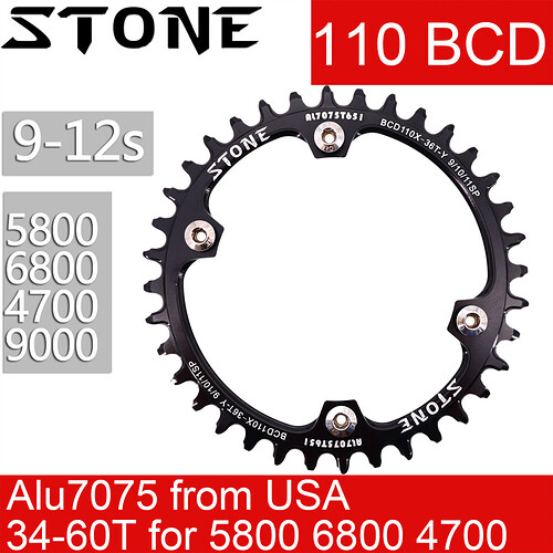

Would i be able to buy this for use as 1x by not gearing down/just staying in the 54tooth without any other adjustments?:
Got Shimano 105 5800 110 BCD.
Product Name: STONE 110 BCD Chainring, narrow and wide
Material Hardness:HB150
CNC process precision:0.03mm
Color: black anodized
Size: 110 BCD, round
Thickness: 4MM
Speed: 9-10-11-12 speed
Fit for shiman.o 5800 6800 4700 9000
Yep should work fine. If your thinking about removing the Front Derailleur you might want to think about replacing it with a chain guide, it’s not required but I won a TT last year because the guy who was faster than me dropped his chain.
At first i was just planning to keep derailleur and just stay on big cog?.
But will look into chain guide :).
Yep that will work, you don’t get the Aero benefit of loosing the Derailleur and small cog. The chainring probebly doesn’t have ramps etc so you might want to disconnect the front Derailleur so you don’t shift accedentily as it will probebly drop your chain, or you might not be able to get back into the ring.
Yea disconnecting for sure!. Thanks for the help.

Instead of disconnecting the front deraillleur, you could also just adjust the limit screws so it can’t move. Afaik if you just disconnect the cable, it’ll move to the small ring.
