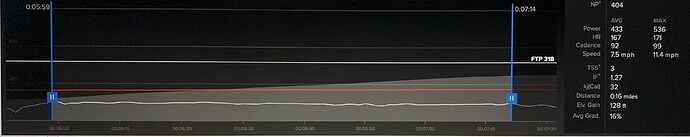

I’ve had a significant fitness improvement this past winter and I was able to test it this past weekend. First actual race since 2019 and 6 mins into the race I was able to test these new raw watts on a climb (1:30 long) that averaged 16% and topped out at 22%.
Hills used to be my nemesis and I’d never pass people, but now I will almost look forward to them. I passed people that were clearly both bigger and smaller than me. Was a pleasant surprise :smiley:! We’ll see if this holds true once we get into the real race season.
