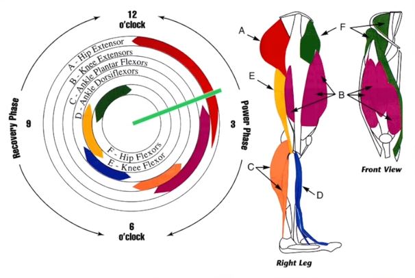

Together with the chart for muscle recruitment that @gpl used in his video, this starts to make a lot of sense.
muscleRecruitment
So I feel we can argue all day long whether big or small ring is easier - because it will depend a lot on what and how you’ve ridden in the past. The artificial/‘low inertia’ feel of riding the small ring on the trainer is actually very close to what I ride outside: Either doing weekend outdoor rides focussed on climbing or commuting by bike with artificial braking (pulling a trailer and having a child seat on the back for added drag). So it would make sense for my muscles to be conditioned in a way that training in the small ring would feel easier to me, but not for someone who is used to different kinds of efforts.
