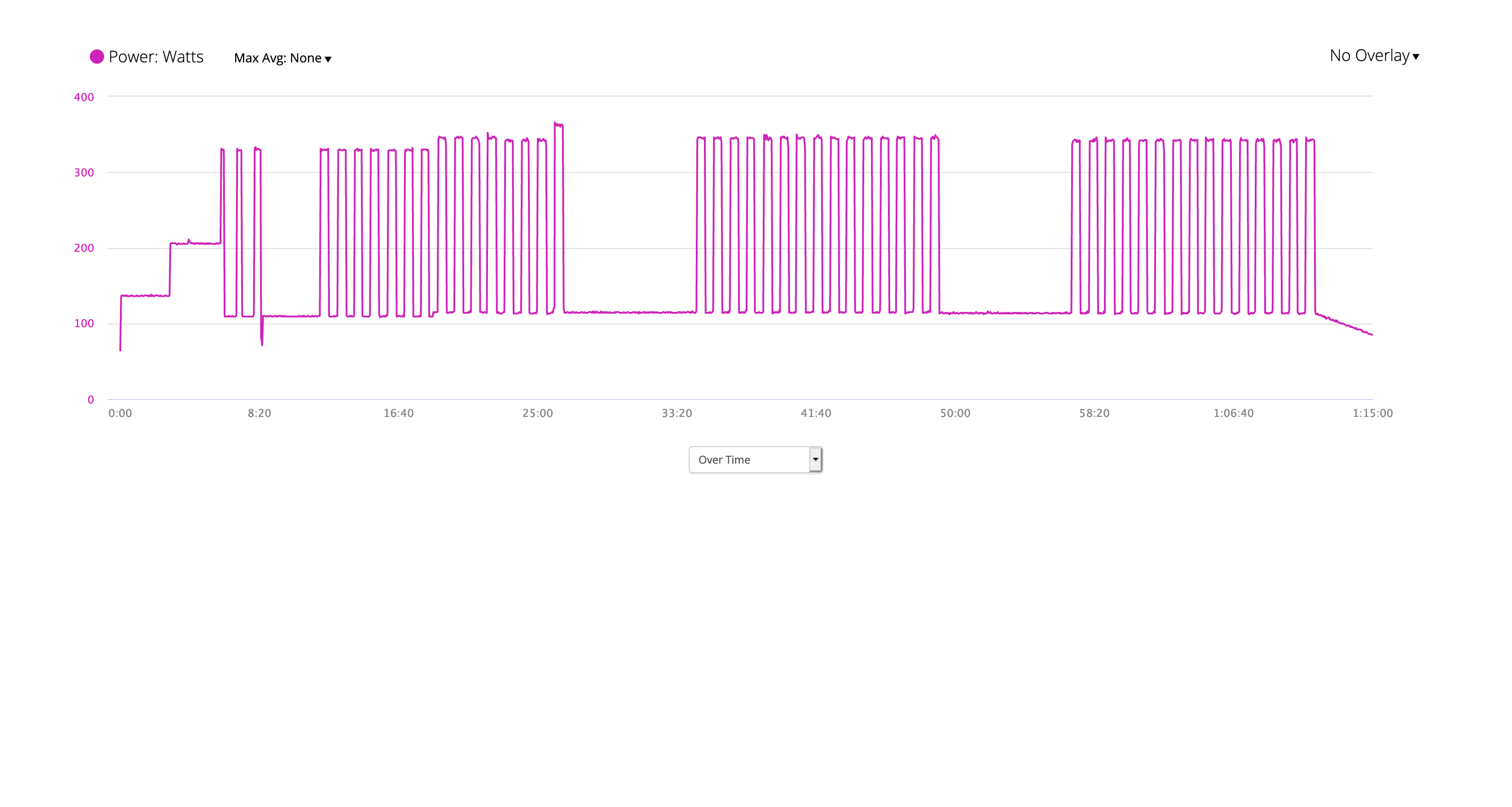

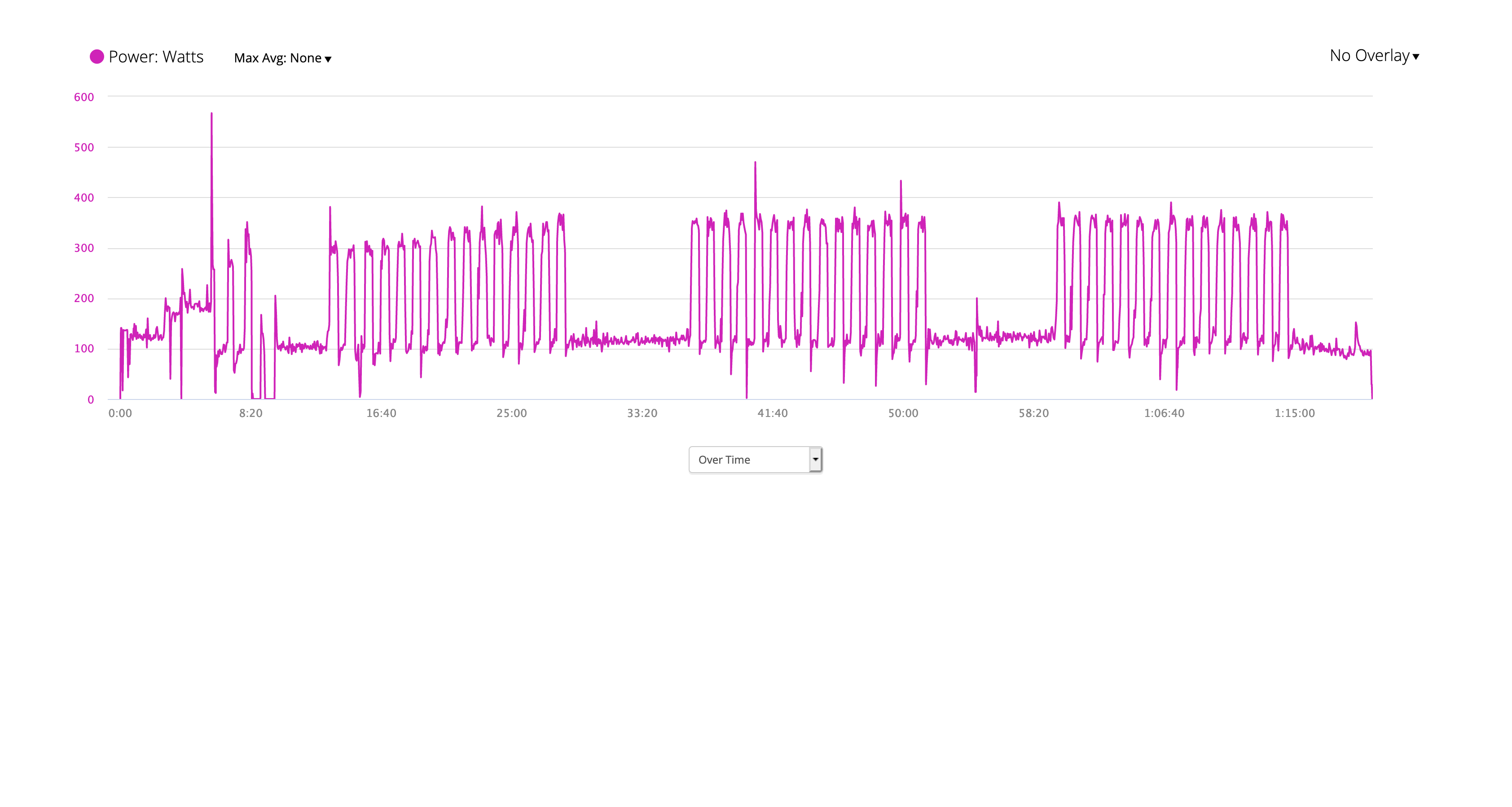

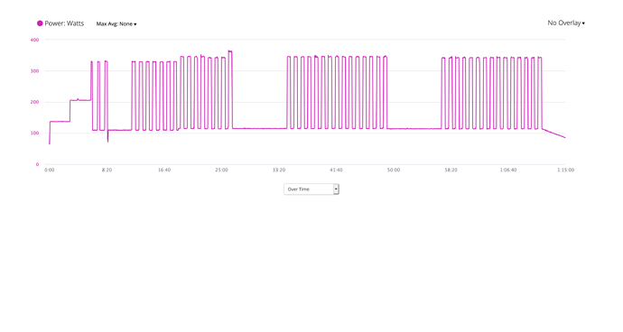

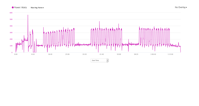

What I’ve noticed with the Wahoo Kickr and Vector 3 dual sided peddles.
10 min warm up then perform a spindown calibration, and calibrate the peddles.
Today I was doing taylor -1, so VO2 intervals with the peddles on the garmin, trainerroad on the kickr. The warm up and first 2 intervals (of the first set) are on the big ring, from there swapped to the small ring as the power was 10% down, target 330, actual 300ish. Dropping to the small ring actually made things worse initially.
What you do see from the data though is that as the trainer warms up the 2 power meters gradually come back into line, after 26 minutes riding time they’re both reading almost exactly equally. My surprise here is how long and how hard you have to work it before the trainer warms up. I’ve felt something was a bit out now for a while, looks like it’s solved.
