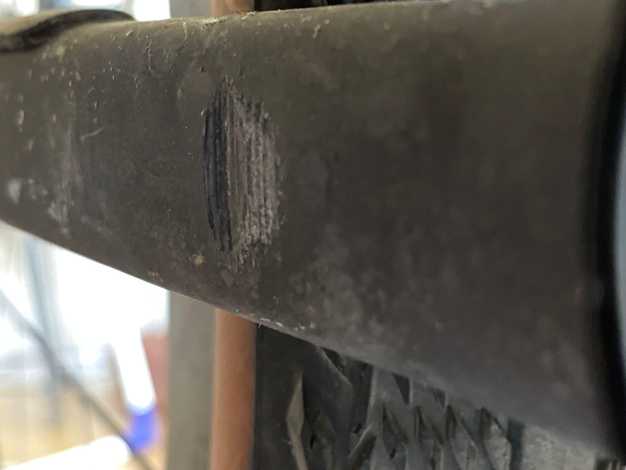

Factor recommends 38’s. This is not a huge deal, but what you mention about teeth potentially damaging the frame is.

You get that with a lot of frames, and a lot more than is commonly spoken about.
I just sold my Crux which had a 46/33 mounted to it. It wasn’t even particularly close to the seat stays and voila:
Same experience with the Aspero and 1x.
It’s really smart that Factor have a little place in the dangerous area there.
