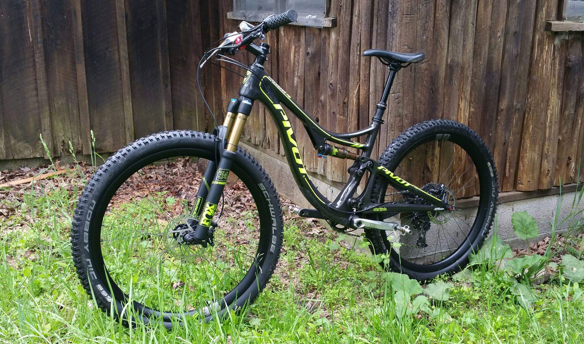

Those are some seriously aggresive tires for a 22mm rim. I’m not familiar with the Spank wheels mentioned earlier, but a set of Stan’s Arch or Flow (depending on your weight) would also be a massive upgrade and make those tires behave the way they were intended.
Nah its fine. The tyres come in 2.3" which should be ok on 22mm rims. I run them (or 2.4" tyres) on 23mm Hope rims and they’re incredible. :ok_hand:t3:
No on Stan’s, or at least no on the hubs. Spank makes a nice anchor. I laced up several Light Bicycle wheels to dt 350 or 240 hubs with sapim cx Ray’s and they are bomber. I really really like the dt xm hoops if you want to save a lot of money and like the aluminum ride quality. (A little more forgiving)
22mm internal is way to narrow. I run 2.23 knobby nics on Ibis 741s with 35mm internal width on my non boost pivot Mach4 and Mach 6. Something closer to 28mm is ideal.! But that’s just me.

just as a point of comparison… since I am planning on buying a 23mm internal width race wheelset. Stans is suggesting 2-2.25 tires for that rim size. You can almost always run bigger tires than suggested, but the bigger tire won’t perform as it would on a wider rim, much like a tire that is too narrow for the rim would behave a bit funky…
My arch MK3 that came with my bike is a pretty solid wheelset, in the promo video on their website, the trails they’re riding look a lot like the local trial system that I usually ride. Very chunky rock gardens, almost no single track.
The sweet spot for XCO/XCM as of now seems to be about 25+/- mm inner diameter that allows a nice range for tire optimization.
I defy anyone to notice 1.27mm effect on performance. That could be tolerance in manufacture or tyre pressure :smile:
Which difference, the tire size or rim width. I’m pretty confident a 2.4 or 2.5 inch tire will behave differently on the next rim up like i was suggesting going to a 28mm internal width. 1.27mm is a difference of .05 inches but nobody suggested a 2.3 tire.
Edit… seeing your post was for dh minion in 2.3
WIthout getting too hair splitty, the gross gains of a 2.3 on 23mm up to a 2.5 on 28mm and all that is in between is pretty marginal. Unless of course you’re at the very pointy end of elite racing. :slightly_smiling_face:
