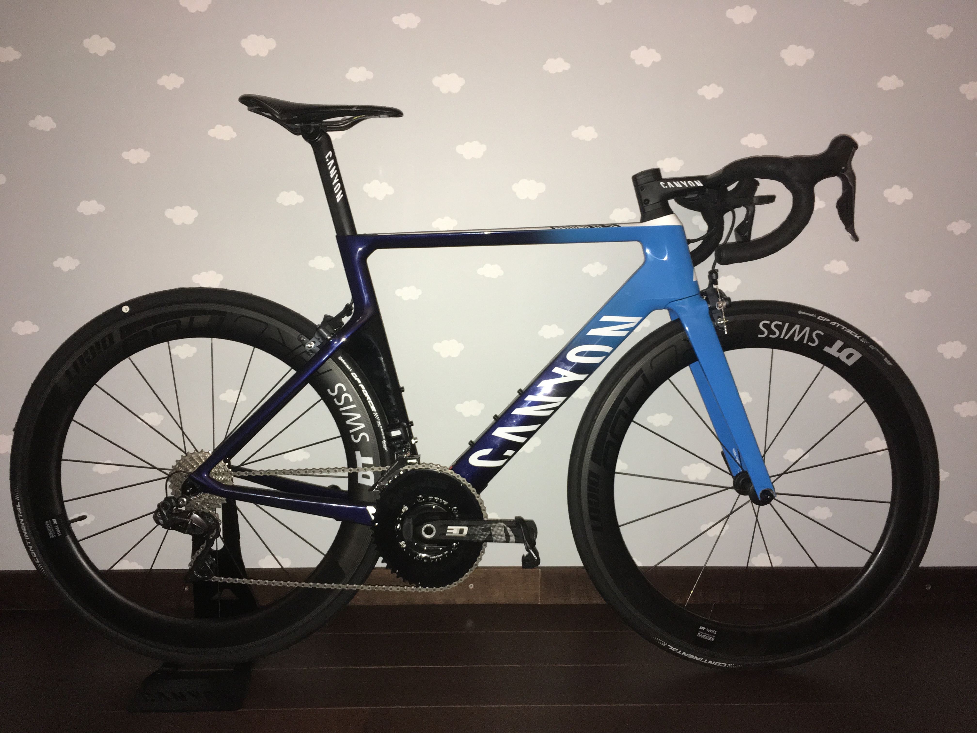

Maybe you should consider (another?) bike fit. I had similar issues 2 years ago and the bikefitter has put my saddle 2 cm towards the handlebar (4cm behind BB) and 1 cm higher and he lowered my handlebar.
All tension dissapeared (neck, back and posterior chain) and I have a more aerodynamic position. This is the position on my new bike. Before I had an endurance position.
