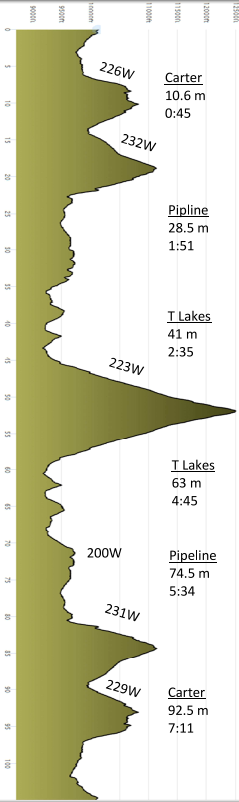

If anyone needs a timing sheet with goal times etc… I put this together. Fits perfectly on the top tube. This is for my stretch goal of 8H. I stole some of this from someone in an older Leadville thread on here. Easy to overlay your own times, power targets, etc… Really came in handy for me last year.
Love it, what weight are the power targets based on?
This is for me at 180 lbs. The power targets are somewhere around my .75 IF adjusted for altitude which is pushing the pace (maybe too much)

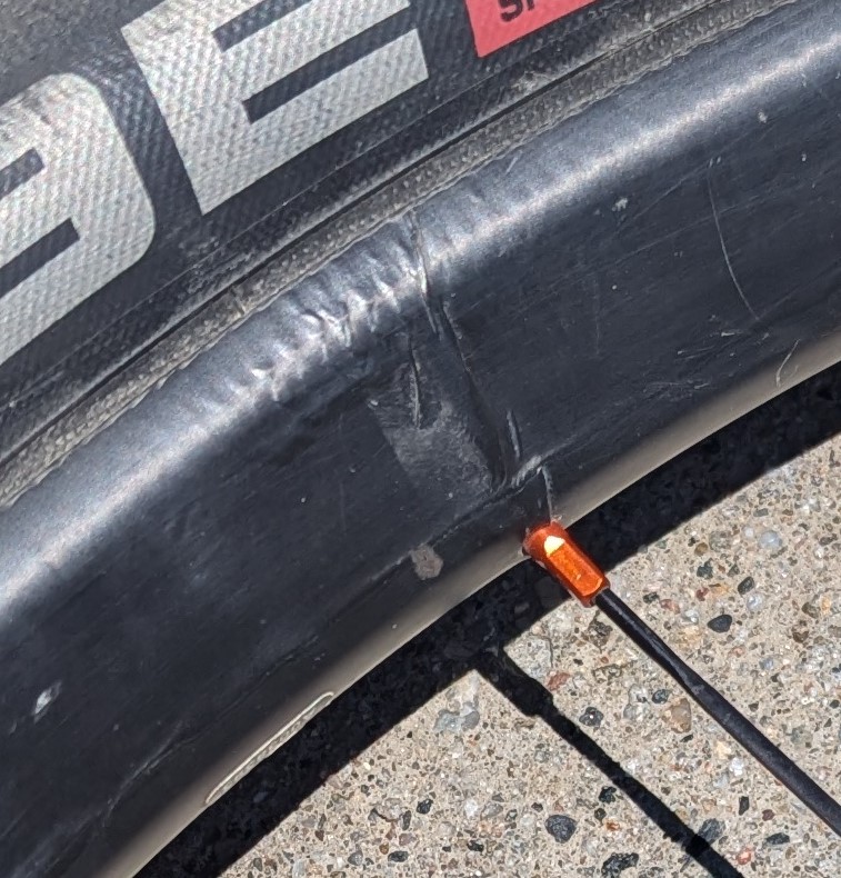

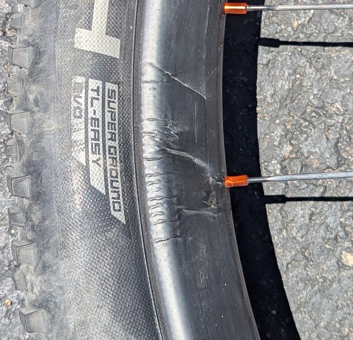

Well it’s a good thing I brought a spare set of wheels as I gave the rear on my “A” set a good enough whack to knock it out of true and show some deformation on the rim in a couple of places on the drive side. that’s going to be an expensive repair when I get home. I wouldn’t have ended my race, but sure would have put a handy cap on it.

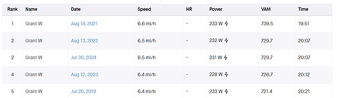

Also, I often post about the leadville climbs being “math problems” because they are so easy to predict based on watts. I was reviewing previous efforts today and here’s a good illustration of my top 5 times up St. Kevins. Different course conditions, wind, different tires, different traffic, different bikes, but on all of these steep climbs it’s primarily watts and lbs = time. Basically all attempts are at similar watts and all times within 30 seconds. Rider and bike weight within a few lbs.

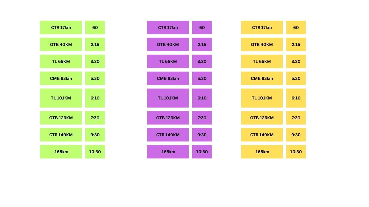

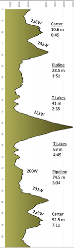

This is my toptube effort in kms for a 10:30 goal. I will decide which colour is best when I pop them on my bike. OTB is Outward Bound and not “Over the Bars” I hope!
I should probably print something before I leave, but I doubt I’ll get round to it if I’m honest.
