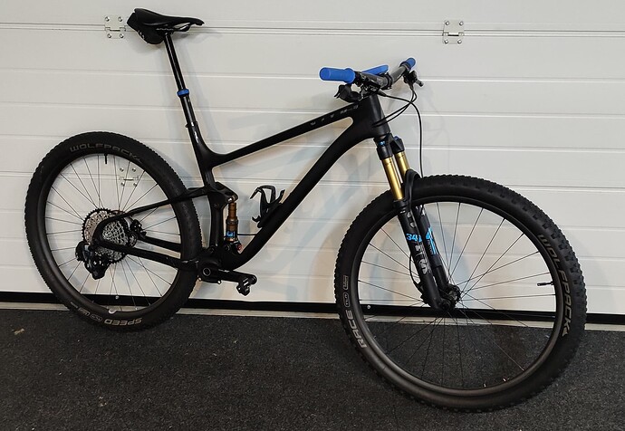

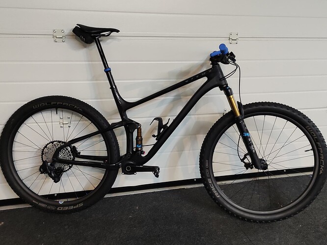

Build is finally coming together.
Still waiting on a replacement end cap from Onyx (hopefully that fixes my binding front hub!!), and a 34T chainring to arrive.
I have also picked up a 32T, which I’m tempted to try as I’ve been reading about people liking the increased anti squat from the smaller chainring, but I’m loathe to install it first as I’ve currently only got the one chain and I don’t want to go to the shorter length and not have the option of running the 34T.
It’s weighing in at 11.2kg which is not too bad, but a smidge more than I was aiming for. I could easily drop below the 11.00kg mark with a few extra dollars if I need. I’m also going to put a 70mm stem on before I ride it, I really wanted the 60mm to work but it’s just too short.

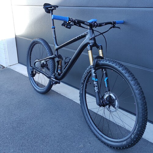

I have a fully functional wheelset. Someone said earlier about Onyx having great customer support and I have to wholeheartedly agree. Taken a few months between back and forth and waiting on postage but a new end cap on the front hub and she spins beautifully.
Having actually been able to roll the bike down the driveway, I may yet be able to use the 60mm stem. The 70 would give me the benefit of a few mm stack which would mean no risk of levers or shifter hitting the top tube. The bike does look good with the short stem and whilst I have sized down it is designed around a shorter stem.
The bike looks great. Love the matching PNW blue and Fox decals.
I’m running 32T on my XC bike for the anti squat and also for a better chainline: it lets me avoid first gear more often on steep terrain and in general puts me closer to the middle of the cassette when I’m putting down the most power.
I did swap to the e13 9-46 cassette for a race that included a lot of fast gravel descents that I wanted to be able to pedal on. Might have missed the top end a bit if my hardest gear was 32:10. But for normal XC racing I’m never in my hardest gear and don’t wish for a larger chainring at all.
More antisquat, more kickback and therefore more rolling resistance.
Larger chainring, less anti squat, more supple suspension, less rolling resistance, better gearing and, bonus, less drivetrain resistance.
This is an XC bike thread, I know which choice I made (and I also had the shock tuned lighter).
Considering a 36-38 next season =].
Interesting: clearly there are more variables that I hadn’t considered. Good to point out the pros and cons.
