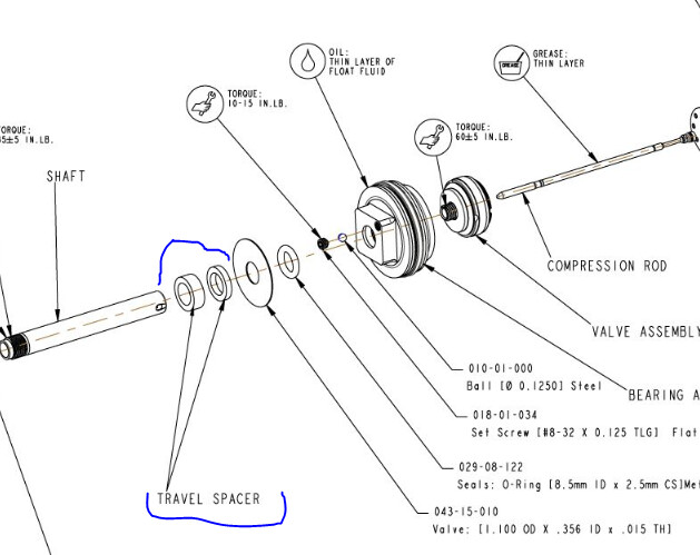

Can someone explain to me/send me a guide on snipping 2.5mm of a shock? I have a 165x40 shock I want to snip to 42.5. Would it be an expensive job for a bike shop?
Easy home mechanic job. Unscrew air can, find black spacer, use cable snips to remove black spacer carefully without scratching shock shaft, replace air can.
a 165x40 MAY only have 1x5mm spacer. In which case the only way of getting a 42.5 is replacing that with a 2.5mm, which is a service centre or suspension tech job. If it has 2* 2.5mm, just remove one.
