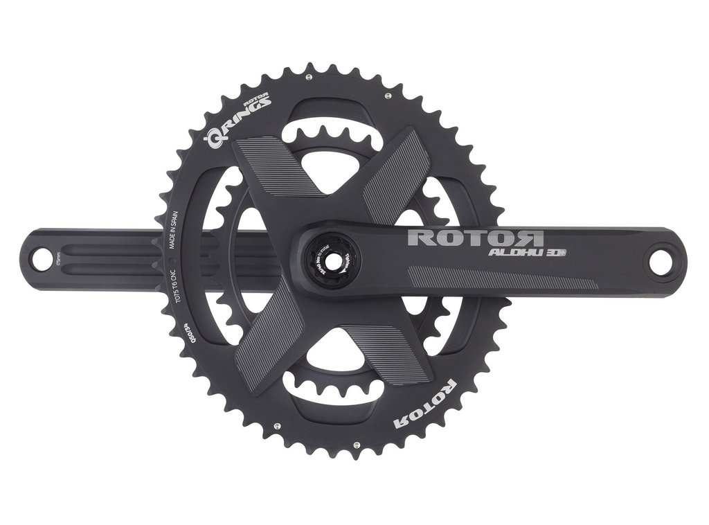

If the R8000 does not work out for you you can consider running a rotor crank. The ALDHU is a nice 3 piece modular and uses very nice splined chain rings. After you have setup the crank initially it takes maybe 2 minutes at most to change the chainring out if you have a wrench sitting there.
This is what I do with one of my gravel bikes to change it between a 38, 42 and 48.
If you want to take it a step further you can even have a second chain waiting with a master link but I always just run the chain slightly long.
