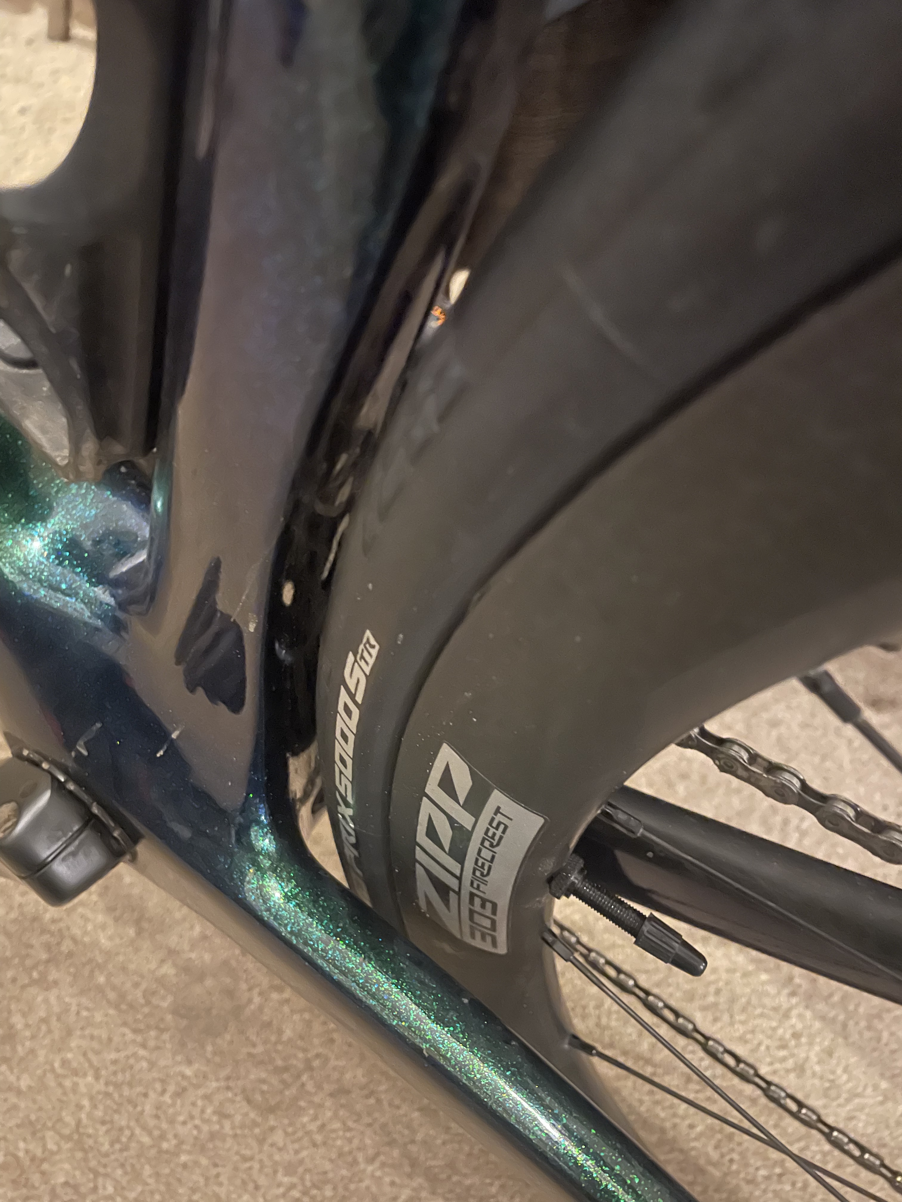

They’ve come up just shy of 34. Just over 5mm clearance left up front, just about 4 at the back. I probably wouldn’t want to chance anything bigger at the back - the seat tube gap is the narrow point.

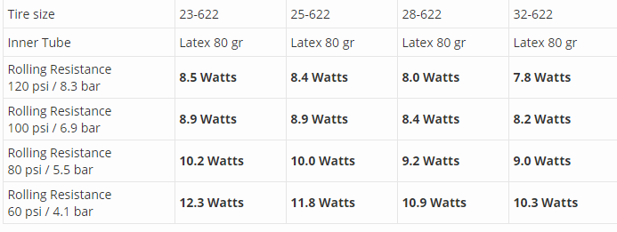

Isnt there a trade off here in lower pressure higher rolling resistance?
Here is a tire tested at various sizes.

At 44psi, BRR puts the GP5000S TR (in 32) at 12.8w. That’s just below the pressure recommended for me by the SRAM tyre pressure calculator (and as established earlier, 48/45 is probably a bit high). At 60psi (the calculator recommends 62/58), BRR has the P Zero Race TLR at 16.9W.
Now while the absolute numbers don’t matter, (and I couldn’t run the 26 on the 303FC anyway) that does seem to corroborate the idea at the GP5000S TR in a 30/32 will be faster, grippier and more comfortable than a 26-28 P Zero.

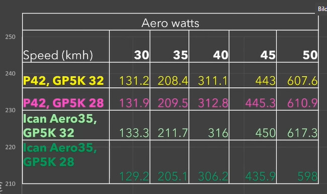

Don’t forget the trade off in aero and size.
