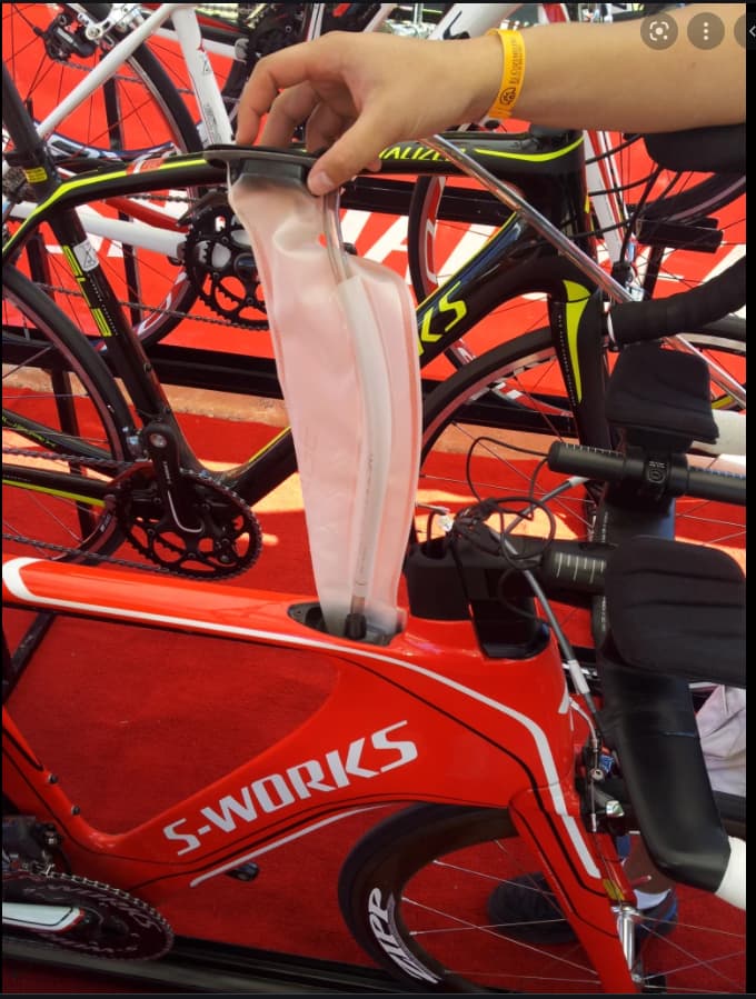

What’s the available volume inside a bike frame? Seems that would make for a pretty aero water store. Just the huge downtube on some of these carbon bikes would probably be big enough.
Hence the reason Spesh made an in-bike bladder for the older Shiv tri model. Despite the space, the actual implementation was less than ideal and plenty of people ditched the great concept and went with BTA, frame or rear saddle bottles.
Let’s ignore their worse solution on the following Shiv tri :stuck_out_tongue:
