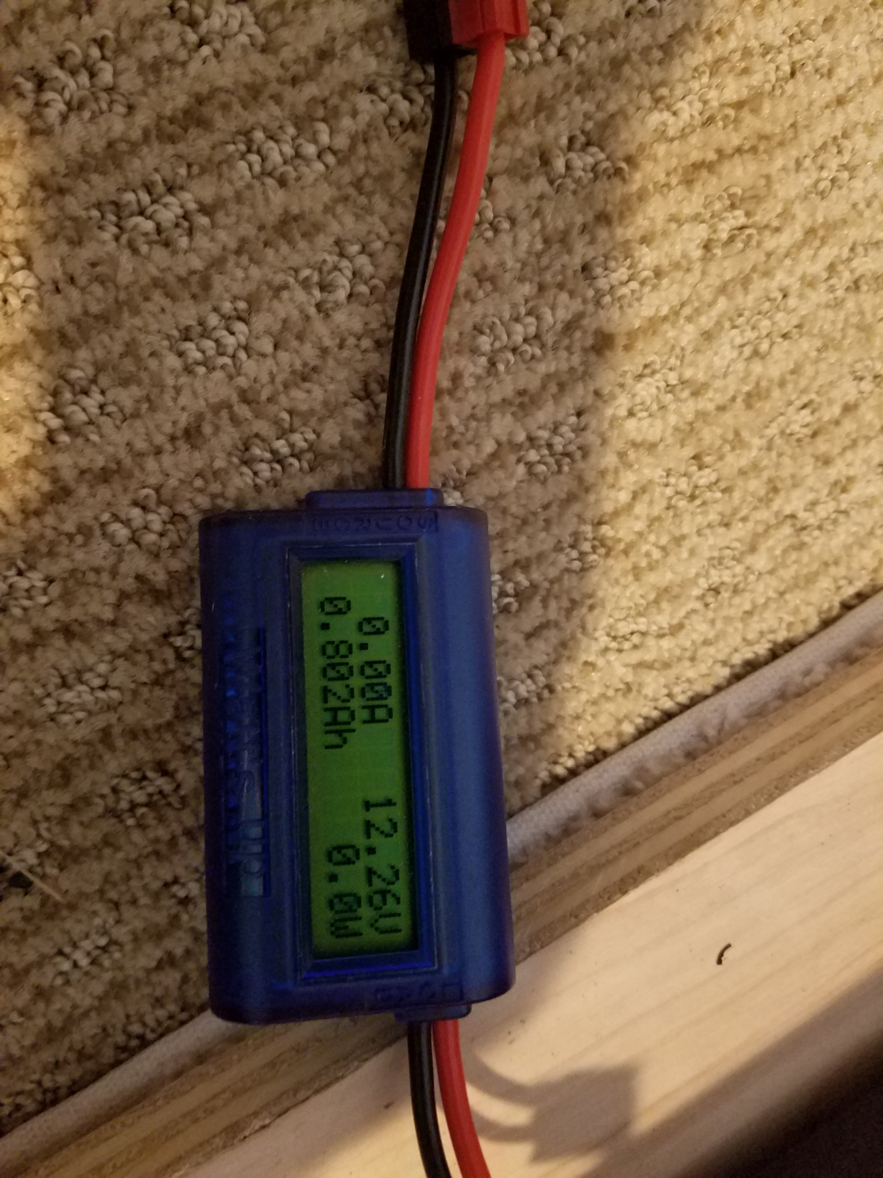

I was curious whether I could run my Kickr 17 off a battery. The power supply output is rated at 12 volts and 5 amps. I put an inline meter between the power supply and the Kickr and measured my most recent workout–McAdie +1 followed by 30 min of endurance. Here’s a screen shot of the meter showing less than 1 amp/hr for the 2 hr workout.
Peak current was just over 3 amps.
My conclusion is that a not very big battery would get you through most of the TR workouts.
