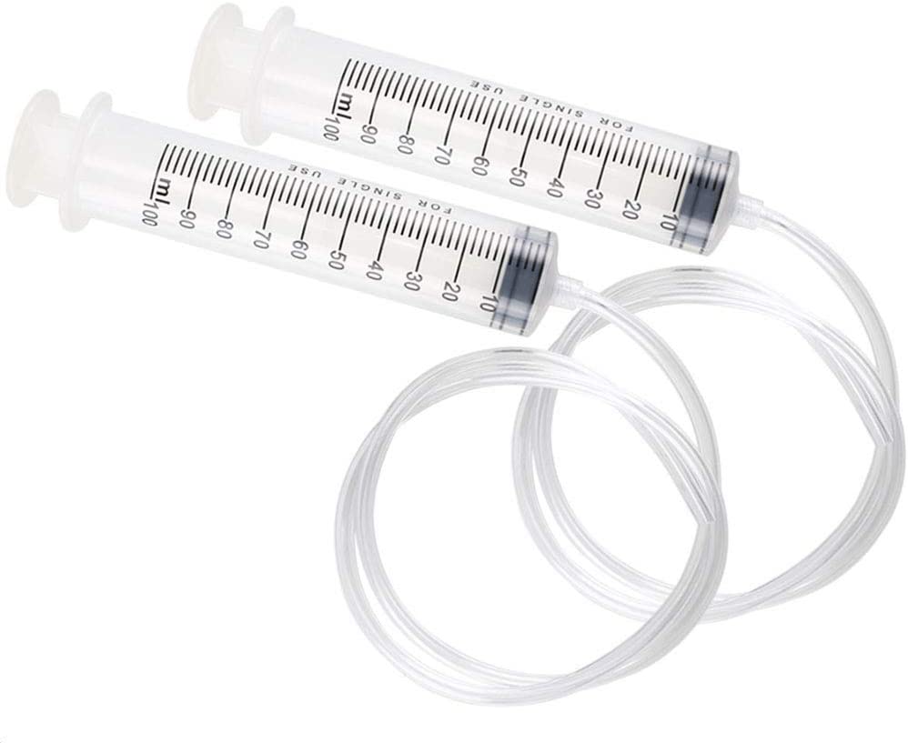

I’m using Stans race at the moment but in the past I’ve used Joes and bike shops have put in Continental and MucOff and touch wood I’ve had no problems with any of them them. The only problem I had was back in 2018 when I almost gave up on tubeless, before I realised from reviews that the FinishLine sealant I was using at the time was duff. I also used stans regular for a bit which goes through the syringe easier but was a little more awkward to set up first time; Stans Race plugs everything fast on first set up. Its takes slightly longer to top up though. Ive found the best way is to use an old 60ml Stans Race bottle, fill it up and squeeze it slowly into the valve (with core removed) being prepared occasionally to rinse out/ unblock its syringe if needed.
