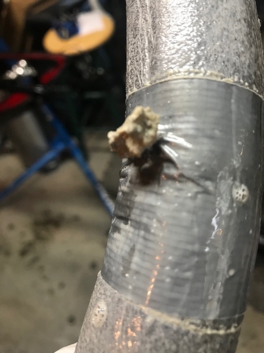

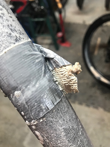

With the tire change, I pulled out the homemade insert and weighed it to see if it’s picking up sealant. There was still ample liquid sealant in the tire, but there was some of the solids “growing” where the zip ties punctured the duct tape. I think the zip ties punctured the tape because I rode it out flat for the last 1km of a ride (in a thunderstorm).
The insert was 56g when I put it in. Coming out, it was 74g “wet”, and then I wiped it off with a shop towel and it was 67g. So I think the fears of the inserts soaking up all of the sealant are a bit overblown.
I put the same insert back in, but I removed the zip ties and just used new duct tape.
