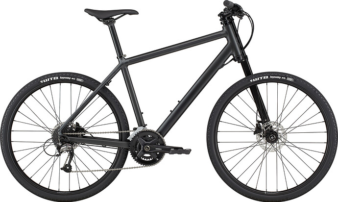

I think this is a great post. It also kind of leads back to one of my earlier suggestions, a hybrid flat-bar bike.
The specs and overall level of these is usually lower and doesn’t go as high as you see in hardtails or gravel bikes, but it’s possible one of these might work. The highest spec Trek option below is a 42t 1x and 11-51 which might be a good option. Short travel fork and decent tire sizes too. Needs a tire upgrade to go tubeless, but the wheels are ready.
