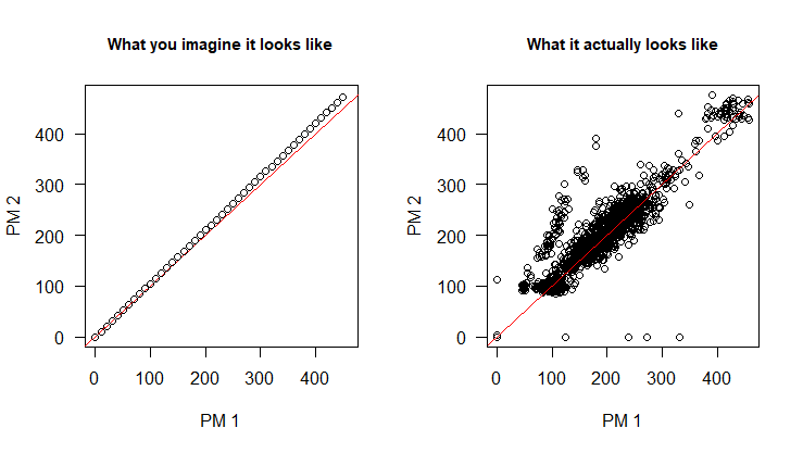

Right. Many people think that L/R balance is constant, and it’s not. Here’s a plot where we recorded a single-sided PM and a crank spider PM (i.e., dual-sided). The average power was something like 3% different, so the left panel shows what the data would look like if the SS was constantly off by 3% (I actually don’t remember whether the SS was on the x-axis or the y-axis, but for this purpose it doesn’t matter). The right panel shows the actual second-by-second comparison.

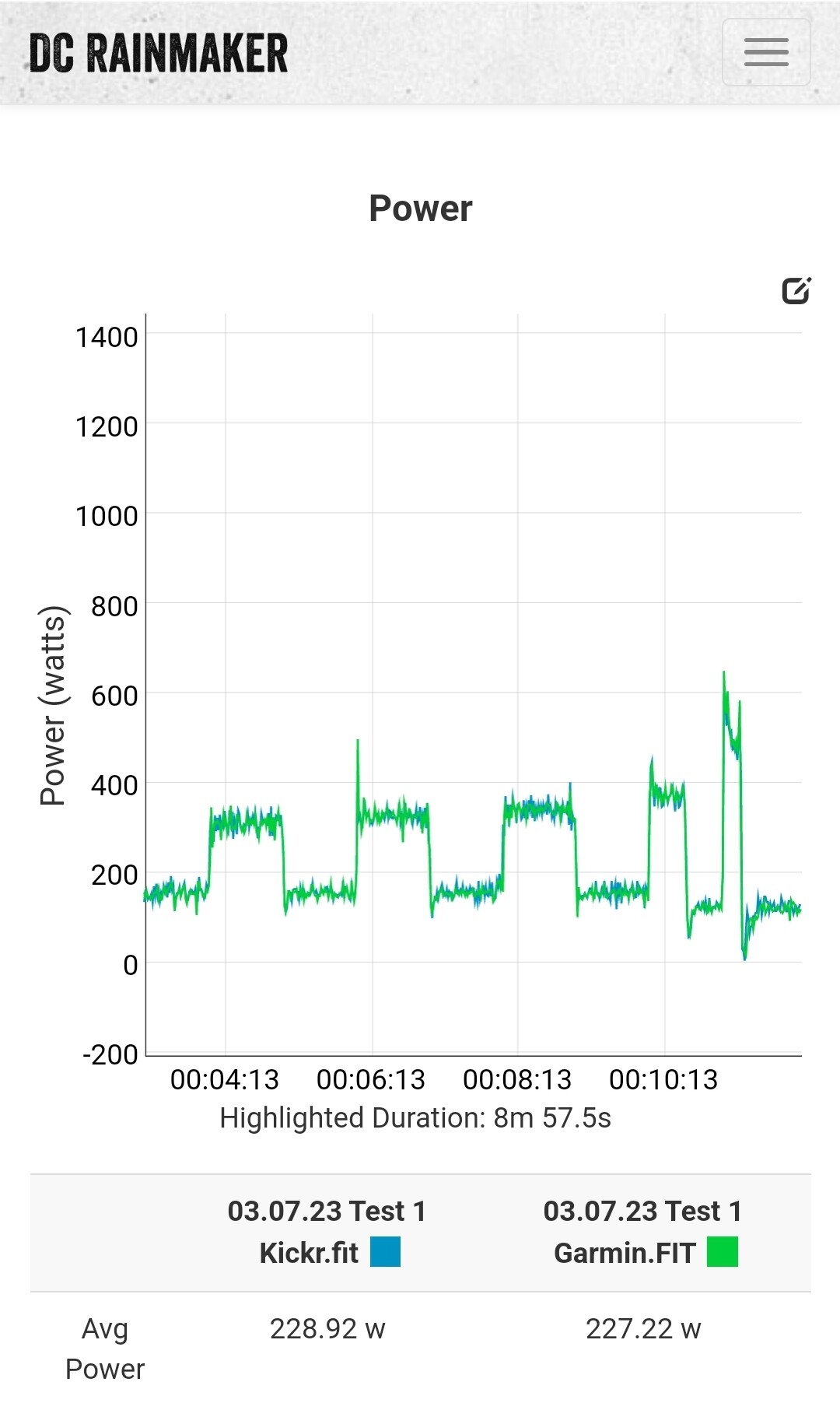

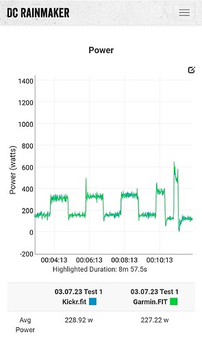

I picked up Assioma Duo Shi pedals and did a quick test ride today, comparing Assioma vs my Kickr Core. They were very close, but my L/R balance is apparently a mess. I guess that’s why the left side 4iiii power meters were reading high vs the Kickr.
This is just a quick section of my ride, but you get the idea :upside_down_face:. I guess I have to knock my FTP down a bit and rely on the Kickr and Assiomas. 4iiii’s might be headed for ebay :grimacing::grimacing::grimacing:
Garmin FIT file is the Assiomas…
