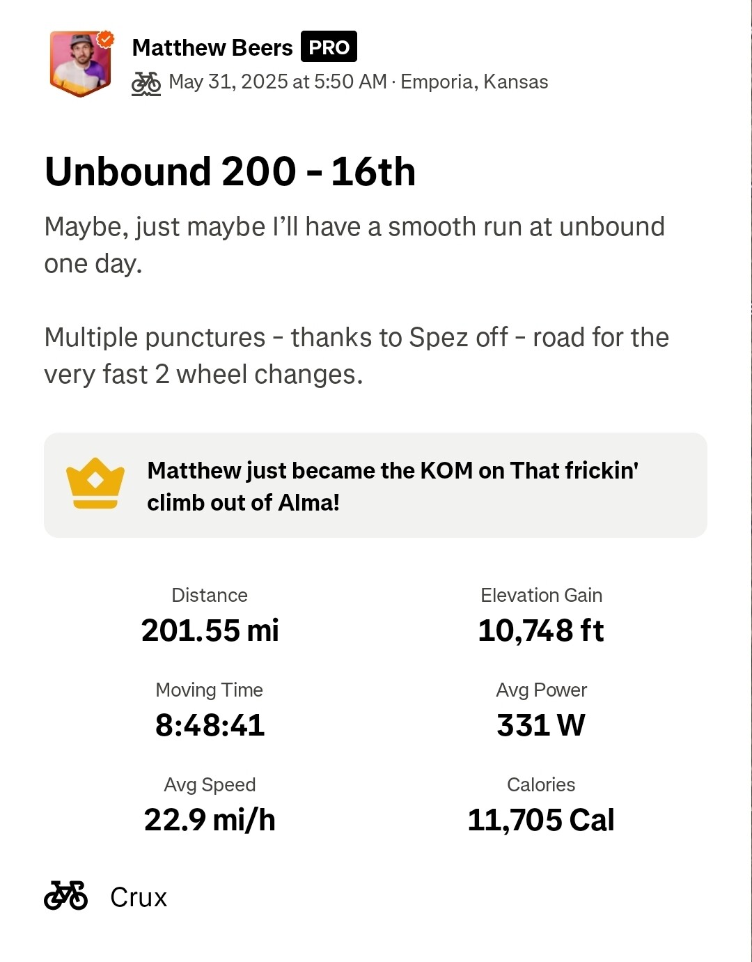

I suspect many more people were on 2.2 Dubnitals this year than 2.2 Race Kings last year - but even then the reports don’t seem to be positive. Lots of punctures and cut tires.
In a similar aspect, I have seen more punctures on the ‘new’ pathfinder pro’s that I would expect. I actually purchased a 40mm for a backup mud tire for unbound but after seeing enough reviews of punctures, I returned it.
Maybe it will gain a better reputation over time, but what I’ve seen so far leaves me a bit skeptical.
