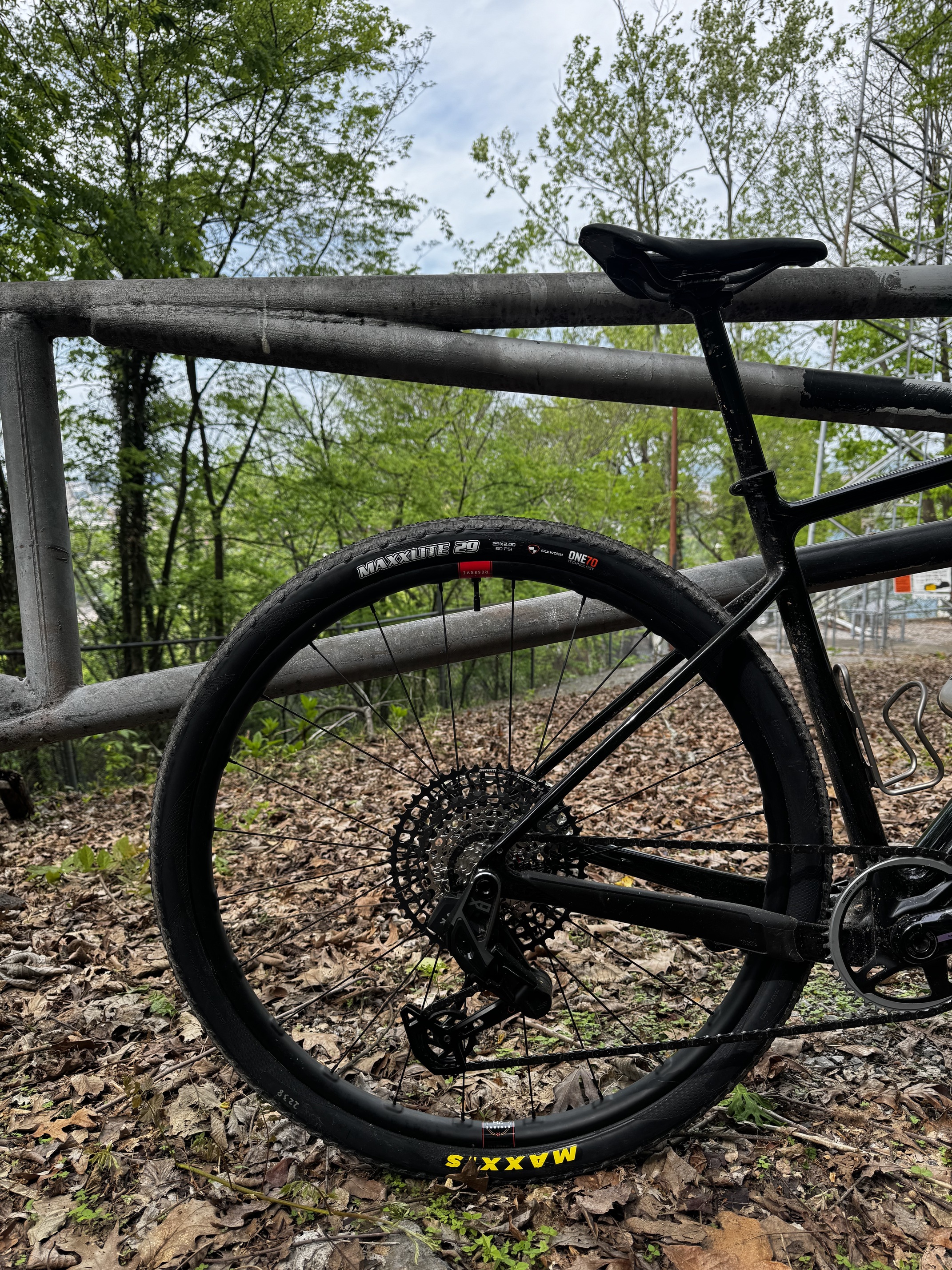

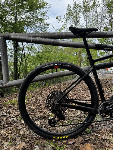

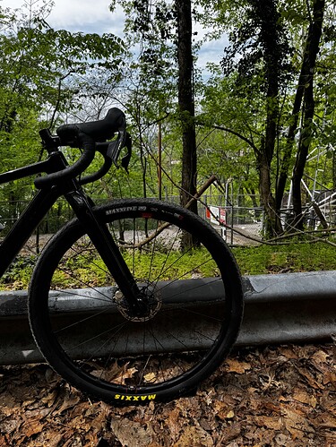

It’s time for me to just buy some thunderburt 2.1 super grounds, slap them on my 29mm internal width rims, and hope front and rear fits my crux!
Hmmmm…don’t think that combo will work in the rear. Should be fine up front, though.
Report back and let us know!
I’m pretty sure it won’t fit in the rear because of my 29mm rims making the 2.1" tires run a bit wider. I’m more crossing my finger and hoping the tires don’t stretch.
If they don’t fit in the rear, I’m going to run my current s-works pathfinder 42mm that runs at 47mm actual width.
I tried this way, and posted photos of this on a thread here, way back in late 2023… Nextie 29mm internal rims, with 2.1" TB’s left about 3mm all around in front, and less than 2mm in the rear… So no, they don’t fit in the usable sense of the word.
Darn. <2mm, even in the dry, sounds like a potential frame disaster that I shouldn’t risk.
I found the TB’s to stretch 2+mm in the week or so after install on 27mm wheels.
