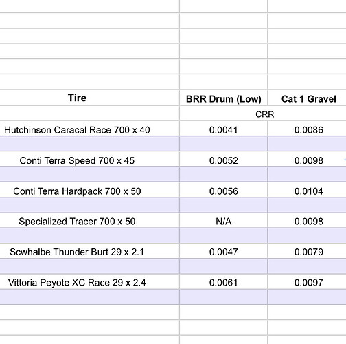

Wasn’t planning this at all, but landed a spot for Cat 4 Gravel Chung Method testing today.
It’s pretty sketchy, so not putting it in the regular test course rotation but definitely interesting.
IG post here
Excellent, very interesting. Did you manage to ride the course without braking? That must be tricky, as well as the challenge of repeating the same line.
Interesting stuff yet again.
The Thunder Burt jumped by 0.0066 CRR from cat 2 to cat 3, and by 0.0035 from 3 to 4. In comparison, both of the 2.4" tires only jumped by 0.0037 from 2 to 3. Assuming that ratio stays constant would lead to a CRR of 0.0175 for the Peyote and 0.0189 for the Aspen on cat 4, in comparison to the 0.0202 of the Thunder Burt.
That seems reasonable on such a chunky course.
UK grade 1. Nice
Correct no braking. Took a few tries to get length correct on it!
Nin that sounds quite reasonable to me.

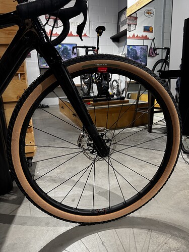

Apparently Maxxis is coming out with something new in April 10th. The good news for them is that the expectations for a good rolling resistance is pretty low…
I know the picture is very fuzzy but these don’t look like huge MTB tires lol
Curious what they are!
My assumption is a new gravel tire in the 50mm range. A 50 rambler? If so, no one is going to care that isn’t paid to ride their tires.
If you need further proof that no one cares… The 50mm Rambler has been out for years… hahaha…

I am pretty sure it is new Maxxlite tyres that they are coming out with, previous one was VERY fast tyre, but literally paper thin, even more so than Scwalbe Furious Freds :smiley:
What do they measure to in real time? Wild that they weigh under 300g in a 2.0…I can’t see how those can withstand anything. Equivalent to an extralight Rene Herse tire.
50 mm wide. Nice profile but crazy thin
