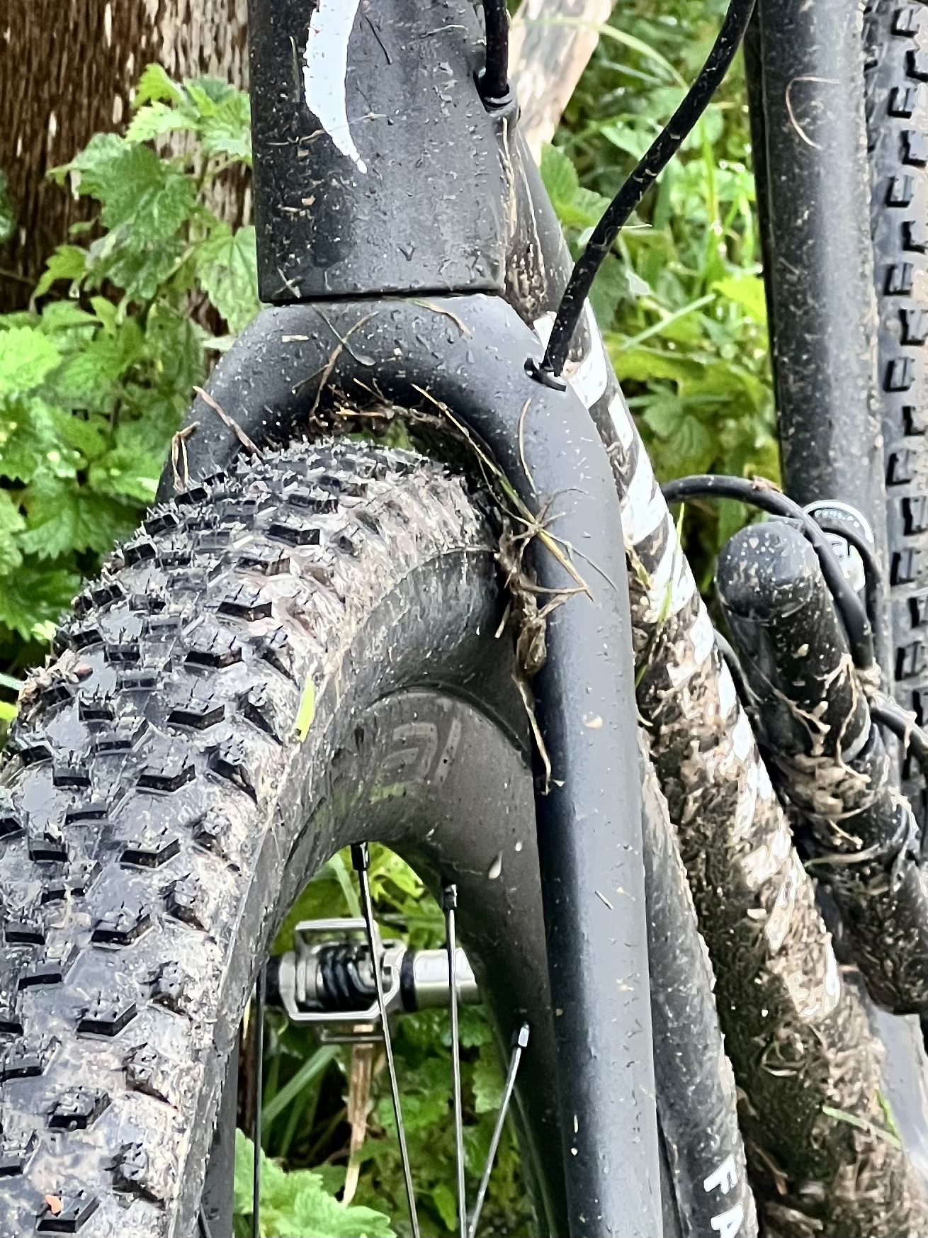

Got a pic of front clearance?

To anyone interested, trying torreno dry endurance casing 2.0 rear and Mezcal XC trail casing 2.1 front. Plenty of clearance left on the stig front and back.
Following the thread I think people are getting 2.1 up front & 47mm back.
I fit a 2.1 in the rear of my crux but would run it on dry terrain only. Maybe 2.5 mil clearance max on the chain stays.

Speaking of Stig and Rudy fork.
Classy combo of Racing Ray and Racing Ralph both in 2.1 fits great for the winter rocky mudfest.
