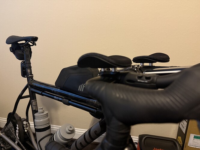

I found the easiest method for raising the pad is just get some M6 spacer something like the following link.
Its a cheap and easy way to try various pad height.
I ordered the spacers and these bolts (18mm in length) M6 x 18mm 10Pcs Flat Head Hex Socket Cap Screws Bolts, 304 Stainless Steel 18-8, Full Thread, Black Oxide by SG TZH (with Hex Spanner): Amazon.com: Industrial & Scientific
Installed this evening. The small height increase definitely feels like it will be a solid improvement and it looks clean/feels very sturdy. I have a rest day tomorrow, but will report back after my 90 min endurance ride on Thursday.
Here’s a pic of them installed:

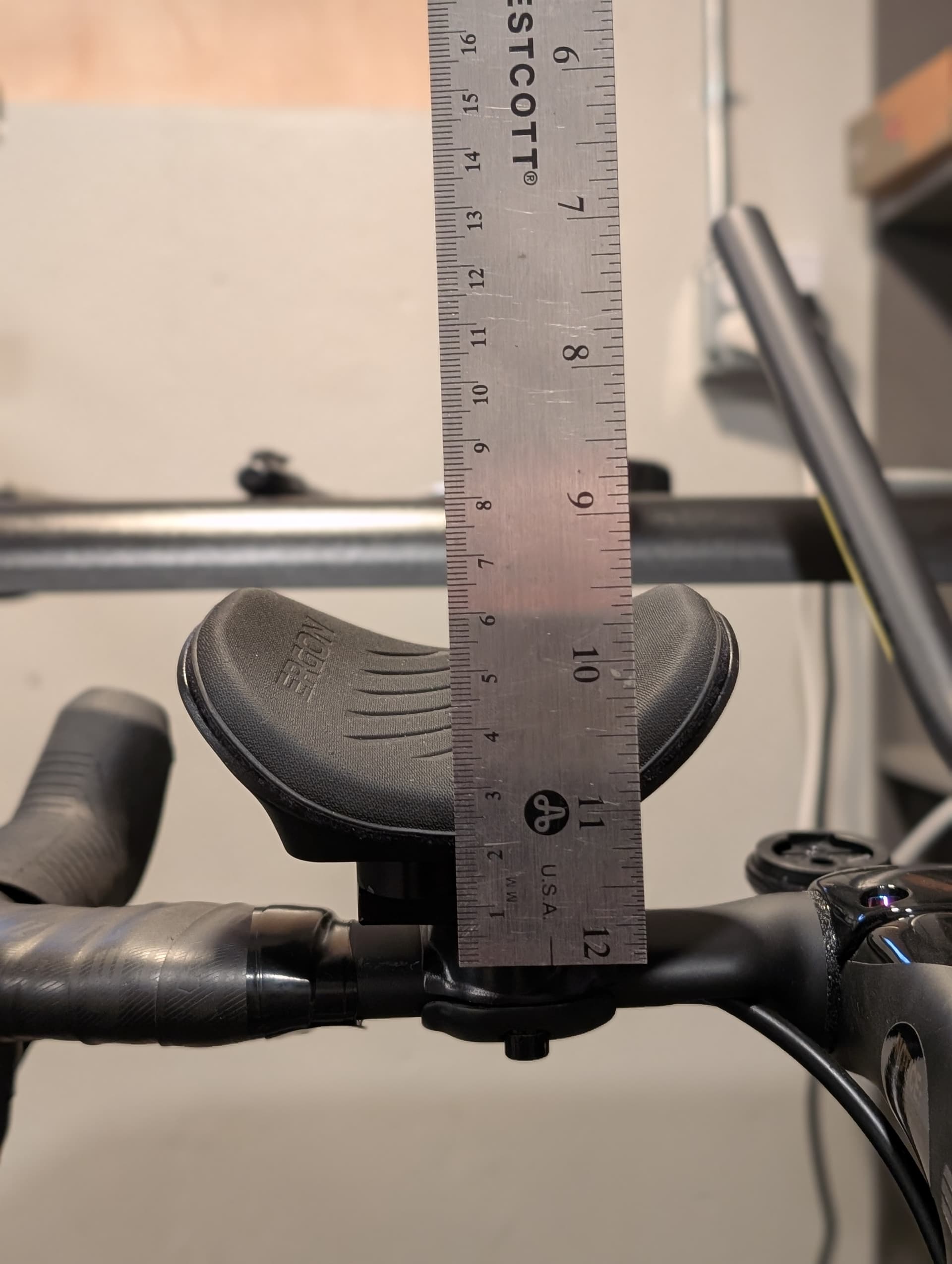

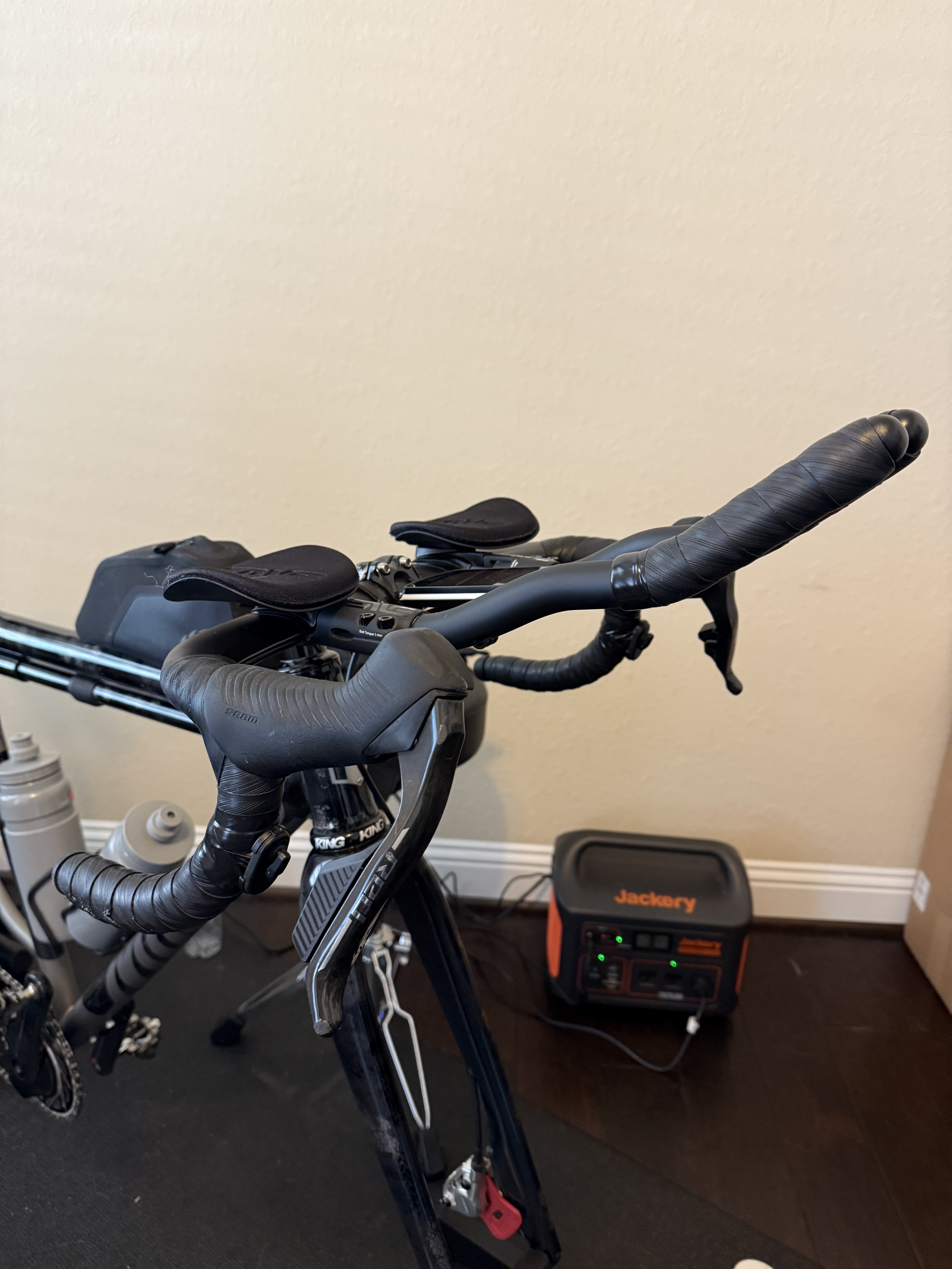

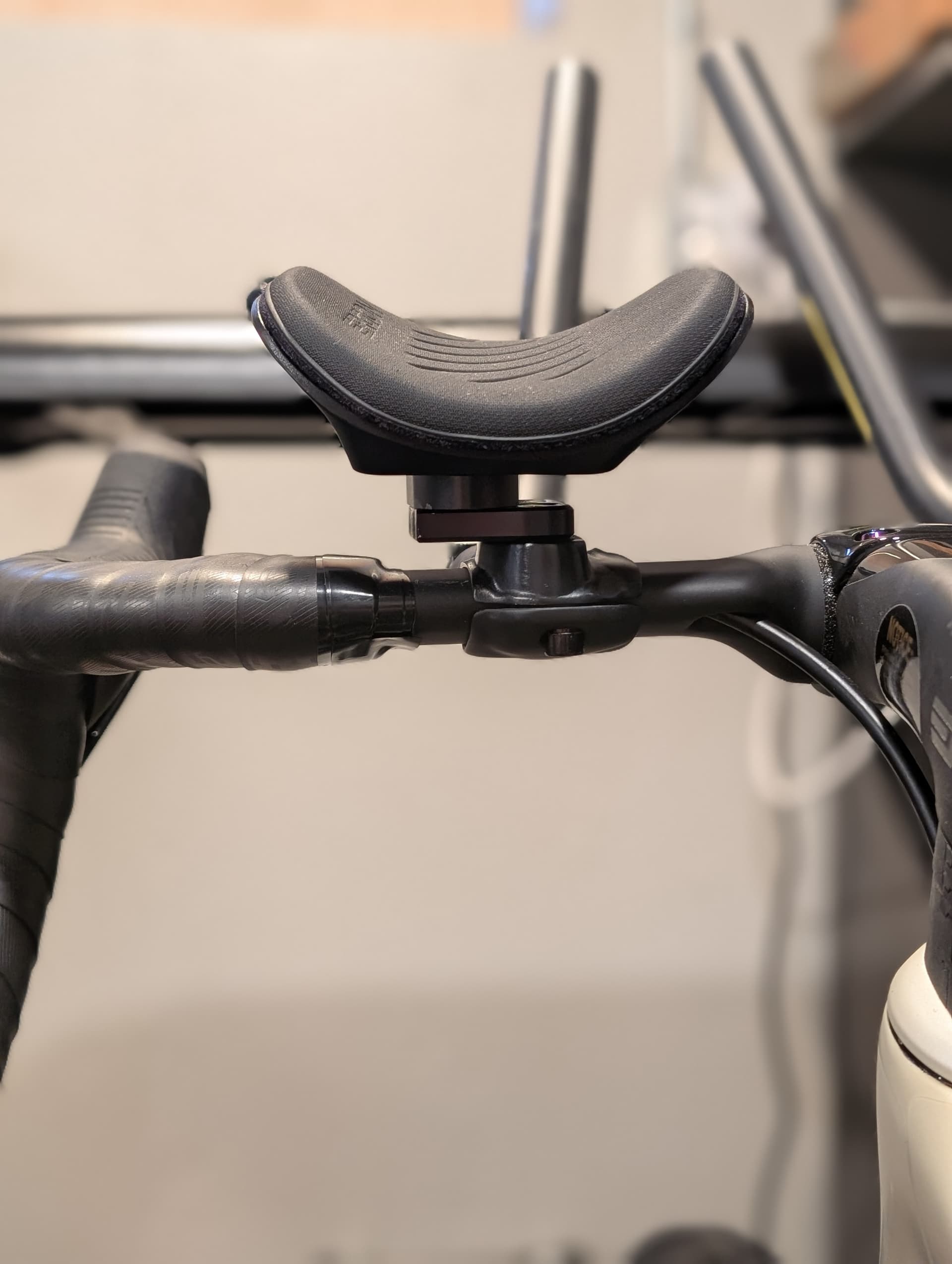

Figured I’d update this thread. I bought TriRig Wingspan Extenders and 10 Degree Angled Spacers, and Ergon CRT Arm Pads to go with my Enve Clip on Aero Bars for the In-Route Aero Bar. Took a little work with a dremel to get the Arm Cups to work, but have everything mounted up now. Profile Design 50 degree bend extensions mounted backwards, I’m on the lookout for 60 degree extensions if anyone knows of any but more than anything need to spend a little time on these.
How high are the pads above the handle bars? Looks like a great set up.
The last picture with the ruler is measuring roughly from the mounting surface of the enve clip-on adapter.
Thanks!! Wanted to get a sense if these would work for me.

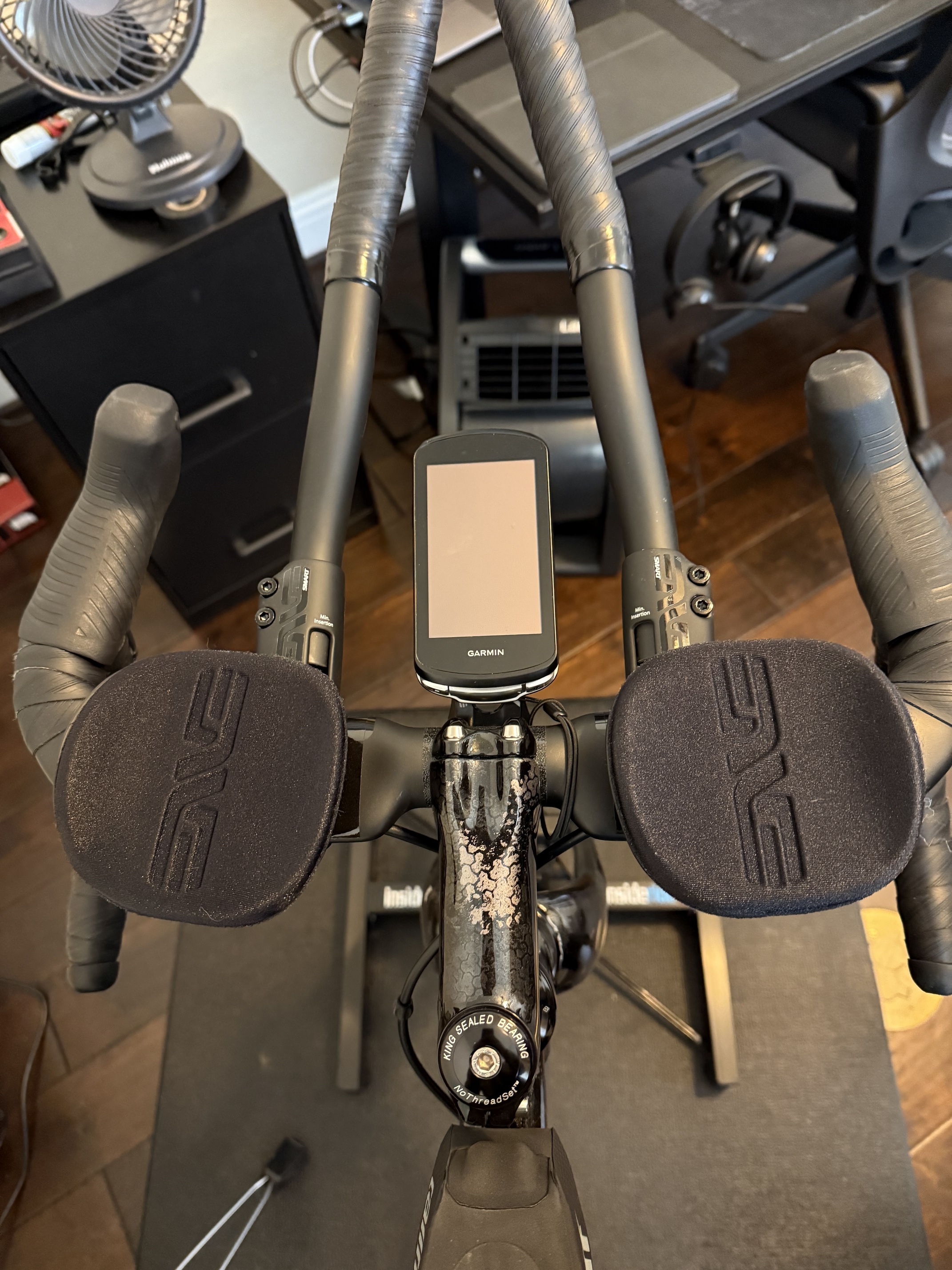

As @grwoolf just posted, these Bontrager bars look like a really nice option. I’ve got a big ole’ race across Europe on the calendar this Summer, and knew that I’d likely want a bit more optimized fit in the aero-bars than even my Enve SES setup offers, so I picked up a pair of the 35/38cm Bontrager Aero Pro bars a couple weeks back. I have yet to even ride them, but initial feel is positive. They have a similar feel/shape to the Enve Aero bars, with just a tad bit less flare. I don’t know how I feel about the angular portion behind the levers, but honestly I tend to hold the furthest most portion of my hoods with only a finger or two, so don’t know when I’d even contact that area. I think its just more of a looks than for me, but I can get over that.
I see you have the offset plate and then that angled spacer. Would the holes line up with just the angled spacer going directly into the Enve mount, or was the offset place necessary for it to fit?
Also, how do you feel about the 10 degree angle. Right choice, or should have gone less/more?
If I remember right, the offset plate was necessary because the angled spacers wouldn’t fit the Enve mounts. Then, had to take the angle grinder to the actual cups too - so a little modification required.
So far, 10 feels right, but I’ve just tested everything out.

You couldn’t have posted at a better time. Seeing both those bars side by side only enriches my desire for the ENVE setup but realizing the Bontrager is likely just what I should do. Which clip ons do you intend to use? Do you happen to have more pictures of the ‘angle’ section you’re referring to? Where did you order from?
When looking at the Bontrager bars straight-on, I’m not certain if you are gaining anything over a pair of semi-aero alloy bars like the Zipps. That frontal area looks kinda bulky.
Yeah, I had the same thoughts when seeing the pics. That leading edge doesn’t look very aero. Maybe they just added “aero” as a marketing feature, but I also know aero doesn’t always look aero. The profile almost looks like a reversed kammtail, maybe there is a benefit to that odd leading profile in combination with the rear being smoothed over. The design looks more aero if you were going backwards. My older Bontrager aero bars have a more traditional thin airfoil profile, not sure why they changed it.
