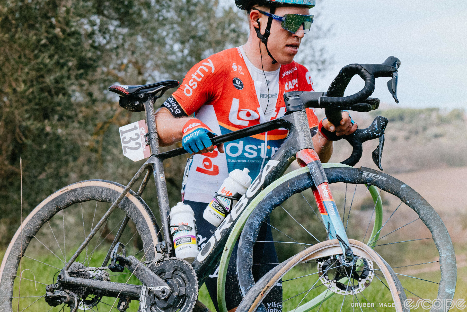

Another Lotto - Dstny tire failure…this time at Strade Bianche.
while Vittoria and Zipp both blamed a rock as the cause of De Gendt’s crash.
Hey Vittoria and Zipp, this is not comforting. An unexpected rock should not cause a tire to blowoff a rim. Cause a flat? Sure. Completely blow off a rim? No.
Zipp really needs to proactively get their arms around this issue. Yes, there is likely a setup issue at play here (and I’m betting on too high PSI as a critical element), but this is a horrific look for Zipp. Especially since they continue to insist that their approved combo (28mm tire on a 25mm internal rim) is fine, despite being outside ETRTO standards.
I am still very much on sidelines on hookless for the road at this point…and if I did go hookless, I would not go over a 23mm internal width. Again, I think a big part of the issue is the “well, more is better” mentality that is prevalent in the bike industry. “23 was better than 21 which was better than 19 which was better than 17, so 25 must be better than 23, right?”
