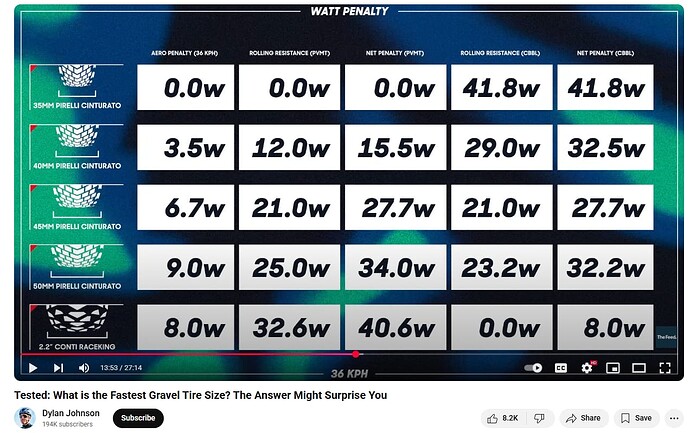

I think this Dylan Johnson video does an excellent job illustrating exactly what you mean when you say that you feel the Patherinders/G-Ones feel faster than the RK. The 35mm gravel tire is massively faster on pavement than the RK, but the RK is massively faster in the cobble simulation.
Your route being 75% road definitely favors the G-One RS IMO. There’s definitely some math to be done here on each specific route to pick the correct tire for the fastest time.
I do a route that’s 60% pavement and 40% singletrack and my choice is the RK. I think a narrow gravel tire would give me a faster overall average speed, but it would be miserable on the single track and actually the pavement section isn’t the fun part of the ride for me, so I would rather setup my bike for the fun bit.
I don’t think this video was indicative of effective testing and should probably be taken down, for the same basic reasons the GCN shoe test at Silverstone was taken down.
How do you figure that? The results basically align with common sense. There’s really no ground breaking new findings. His conclusion is that skinnier tires are more aero and faster on pavement while wider tires are faster over the rough bits.
They don’t align with anything else, including other tests on the same equipment with similar/same tires. The test result also didn’t align with his own testing performed previously, nor the testing from other members of his cohort on Bonkbros.
35mm Pirelli Cinturatos cannot be 32.6w faster than Race Kings, on pavement. Something was wrong with the test, his bike, the tires, or himself.

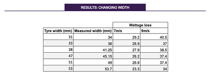

Cycling news found opposite results at the same lab, with higher CRR tires, using the same pavement test roller.
I don’t believe “common sense” has much relevance in our modern times. How many years ago was everyone sure that 23/24/25mm tires were absolutely faster on pavement always? 4-5?
There was a lot of discussion when the video came out here: Is a MTB tire the fastest and best tire for Gravel racing? - #926 by crandallGA
I haven’t seen anything to change my opinion. The R Chung testing from John Karrasch seems more relevant and reliable.
The article you linked is behind a paywall so basically useless to me. However, if all of the different folks testing these tires come up with different results they’re all worthless. Just pick whichever you agree with most.
I personally have three bikes my road bike has 28/32mm GP5K, my cyclocross bike has 40mm Terra Speed, and my mountain bike has 2.2 Race Kings. Oddly, I’m also not convinced that my current 28/32 setup on the roadie is any faster than my old 25mm tires. My average speeds haven’t really changed in any noteworthy way. I do notice that the 28/32 setup is definitely more comfortable on gravel than the 25s though.
I notice that my road bike is the fastest of the three by far on my local 40 mile route that’s about 50/50 pavement/smooth gravel, the cyclocross bike just kind of feels slow and generally is slow compared to the road bike, and my hardtail is the slowest of the bunch but actually is surprisingly close to the cyclocross bike. However, when I do routes that are actually rough, I know which bike I’d rather be on and it’s not either of the two skinny tire bikes. I think this experience for sure correlates with his findings… aka “skinny” tire fast on pavement, “fat” tire fast on rough terrain.
That’s not what is happening. Much of the testing points in the same direction, the SSE-PER results from Dylan do not. As we move further away from them in time, it seems more likely they are an outlier indicating a failure of the test or equipment, and not of a technical breakthrough.
