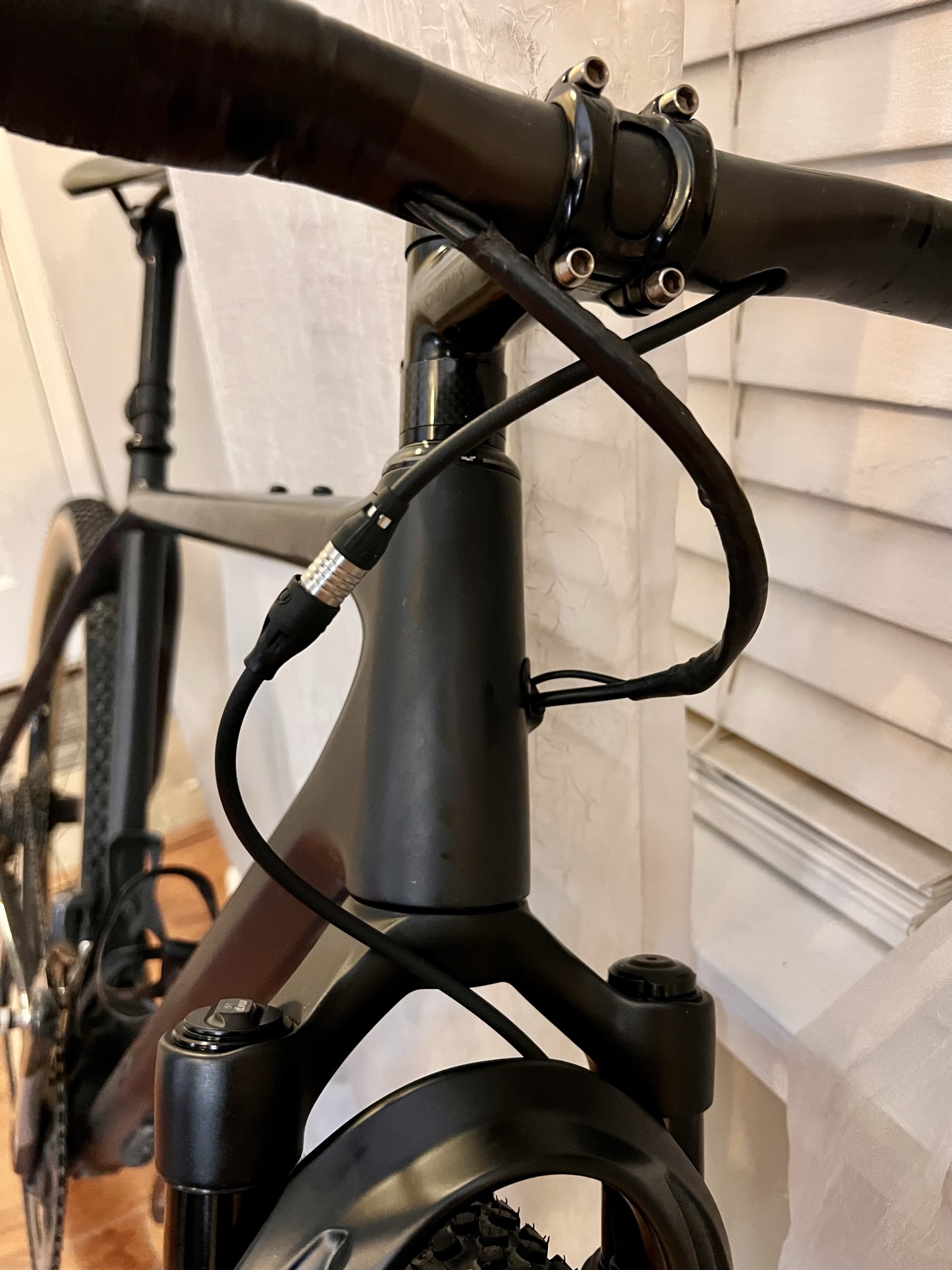

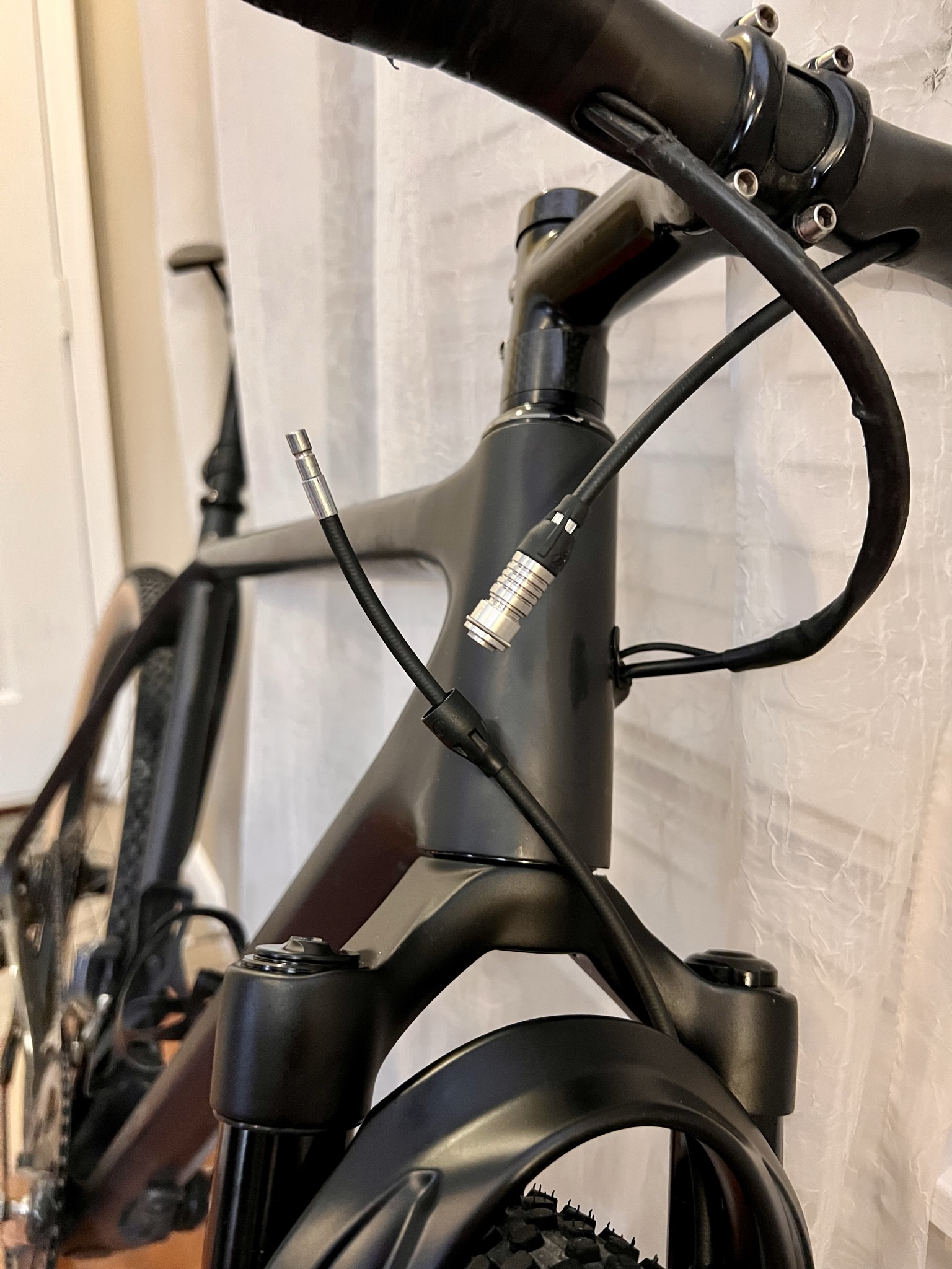

Jumping into this thread a bit late, but think my Bearclaw Thunderhawk build checks a lot of your boxes.
With the MRP Baxter 2.0 gravel suspension fork and the 100mm AXS dropper, I can ride pretty much everything I need to. Clearance for days on both 700c and 27.5 wheels. Current gearing is set up for Unbound XL with a 46t chainring and 10-52 cassette but I run a 40t chainring for bikepacking. Redshift quick release aero bars with sram wireless blips on the extensions for when I want to have extra positions.
I’ve ridden this bike on the first few sections of Colorado Trail and while definitely not as fast on the descents I can still ride everything. The bike just rips.
As far as being able to swap between flat bars and drop bars, you should check out the Formula hydro brake quick disconnects. I ran them for a little on my Open to swap between rigid carbon fork and the MRP, and they did the job. I did however run into issues with brake performance after a few swaps back and forth which could have just been user error. I myself would suggest just finding some nice wide comfy drop bars and running them full time.
