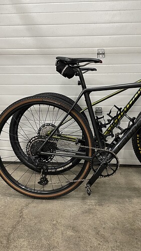

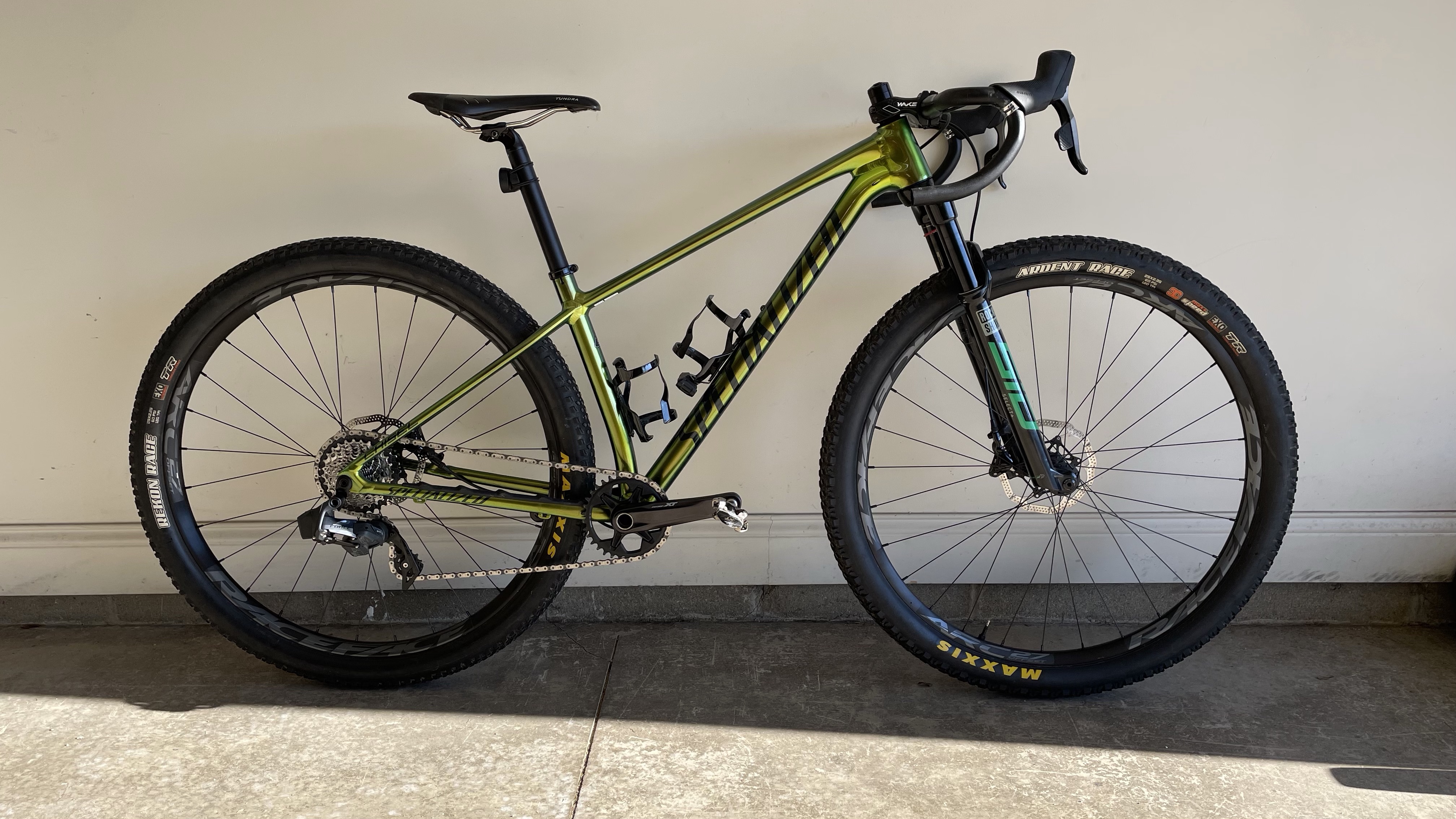

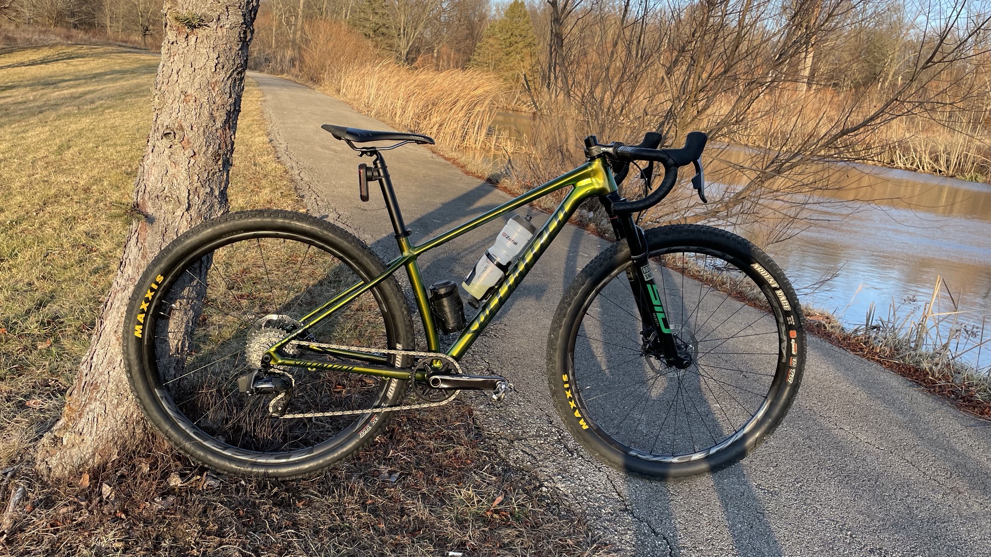

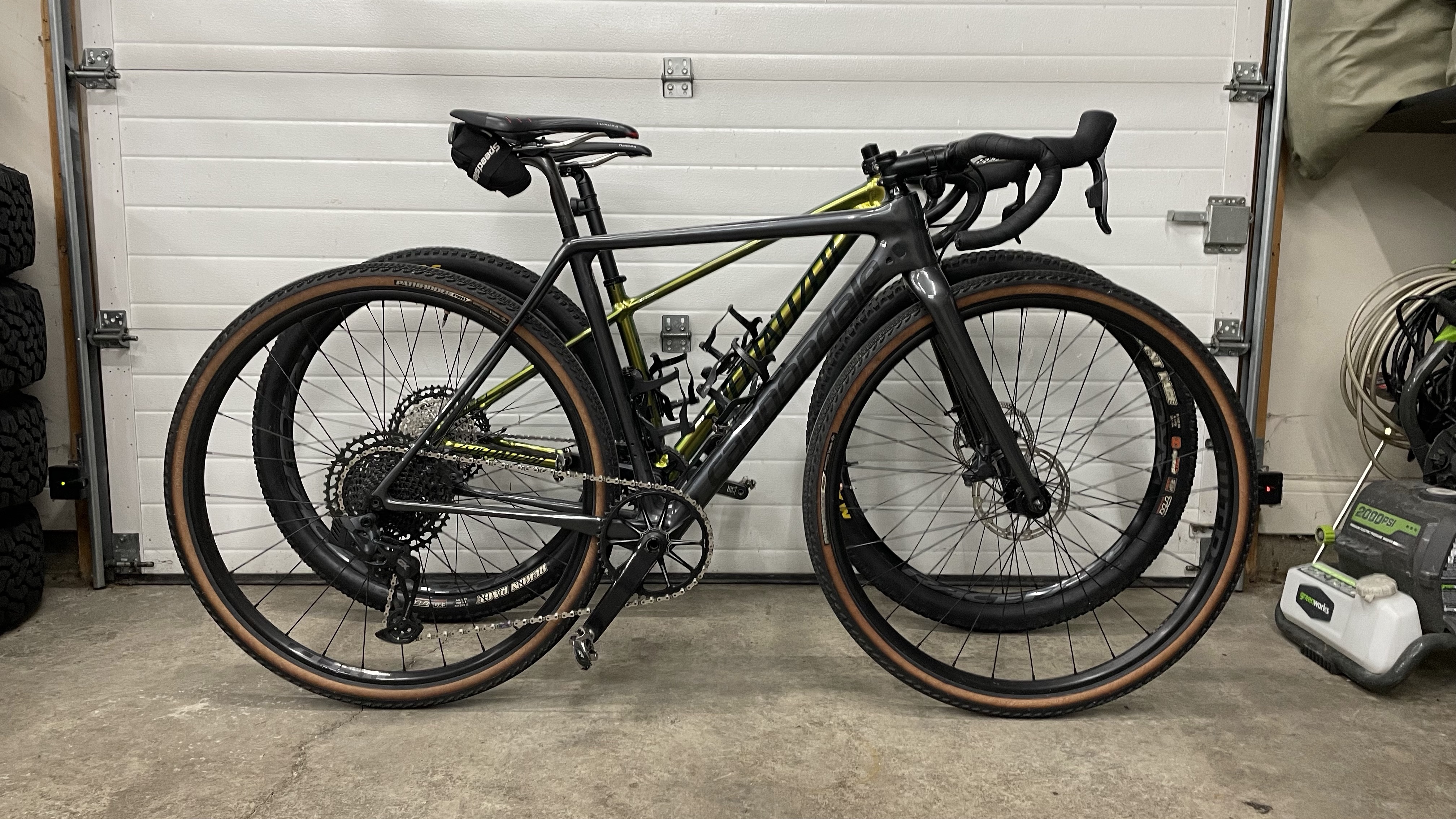

yes it was poster earlier in thread. for center lock 12x100/12x142 to boost spacing for brake alignment.
will not work on CK rear hub though, due to preload collar design. works fine on my CK front and all my DT setups though.
new 27.5 fork has A2C closer to 460mm which is cool with me.
plenty of clearance for a 2.25x29 schwalbe on a roval control SL 29mm ID rim.

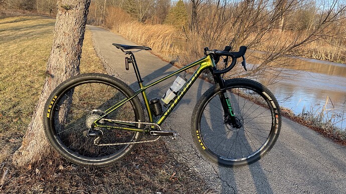

Hey Pottery, can I get some more photos of that 2nd tan fork? Made by TOSEEK right? I am looking at that one right now on AliEx, 460 A to C I believe.
I tried one with a 454 A to C, but it was just a bit too steep, and bit too low of a reach. I needed too much spacers under my stem… i’m 6ft with a long inseam.
You’re talking less than 5mm of actual stack difference between these two mentioned, and less than a 1/4 of a degree of HTA. So you might want to bump up to at least the more commonly available 470mm options if you’re hoping to notice any difference…
Point taken, thanks. I am coming from a 72 degree head angle gravel bike, Carbonda 696, with a 100mm stem.
I don’t mind moving to a shorter stem with a taller fork, but I worry about that wheelbase being too long. Overall, I am building this to replace that gravel bike, I use it for racing, mainly because i’m really looking forward to running race kings or burts. Any suggestions from your experience would be appreciated.
2nd fork is a 500mm A2C Seido BPC (also sold under some other brands).
ah maybe I misunderstood, do you mean the 2nd fork in the first pic of 4 forks or the fork pictured in the 2nd pic? the latter is an sp cycles 27.5 mtb rigid fork.

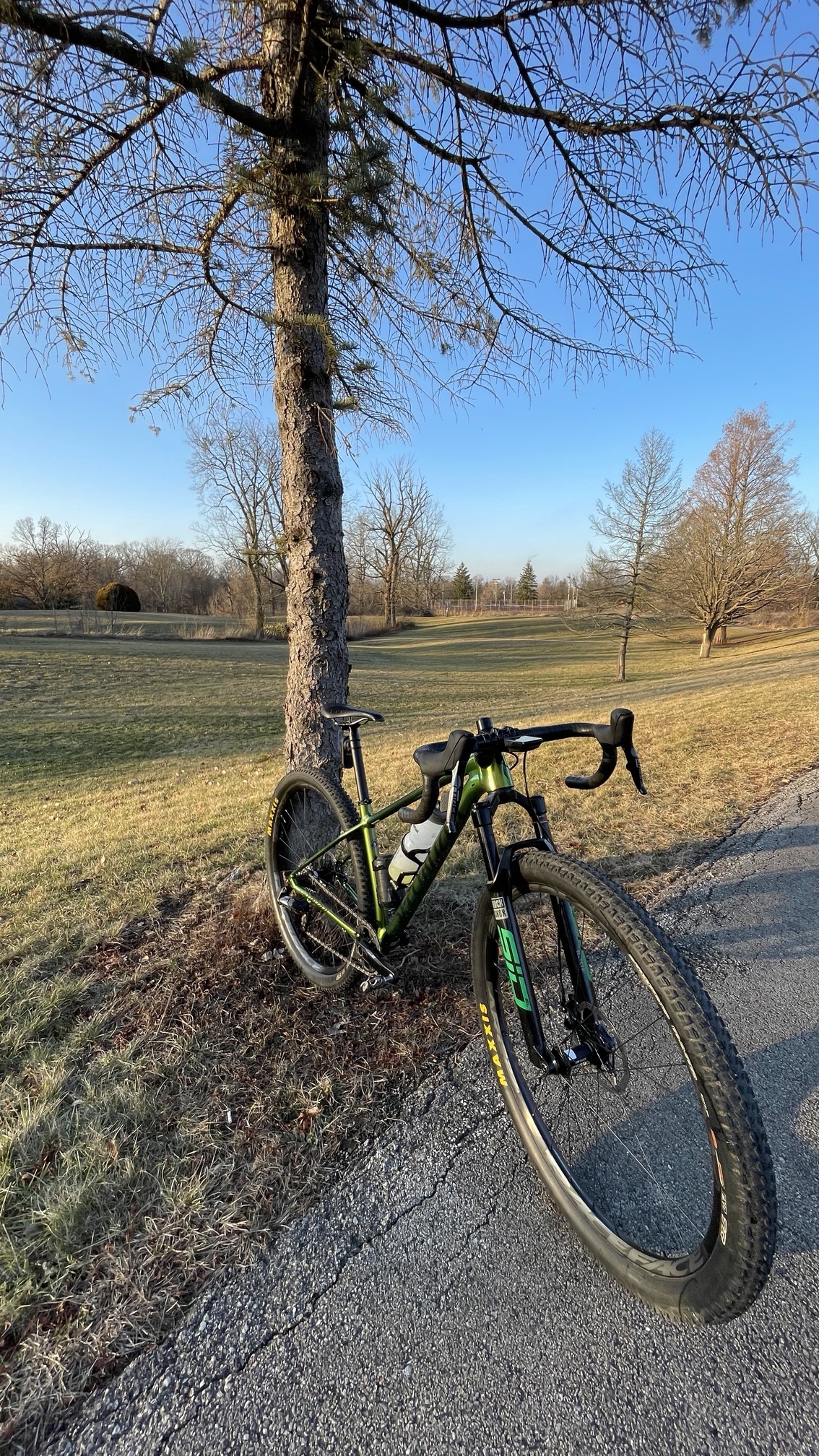

Laurens Ten Dam (ex-pro cyclist turned gravel racer) is building a drop bar S-Works Epic World Cup as his Tour Divide bike. He will be using it for the first time later this month in the Andes mountains.
