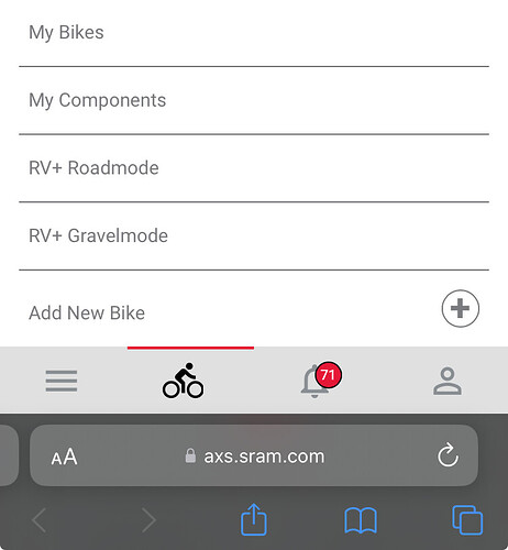

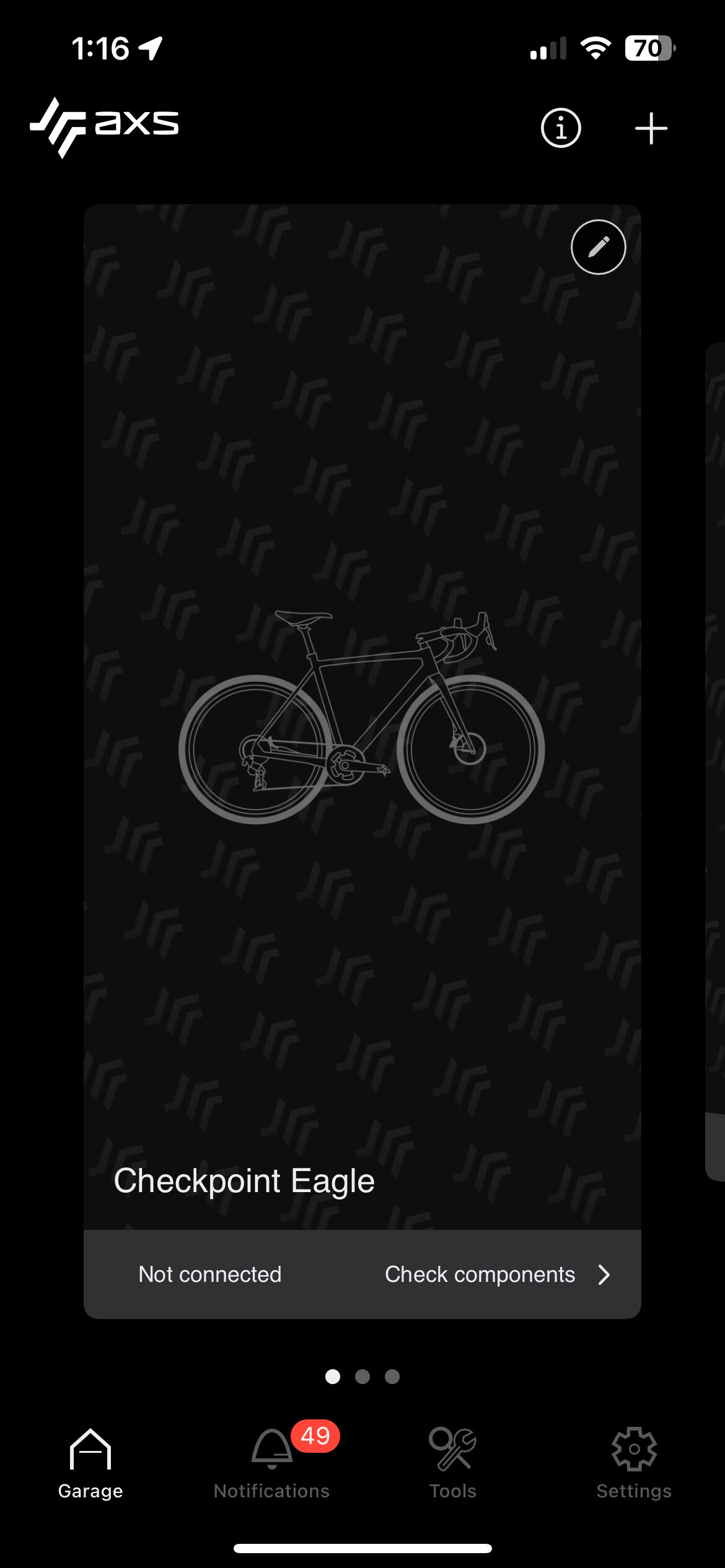

Thanks. I still can’t find anywhere to tell it the cassette in the app, but the website worked.
Have you tried the browser?
Running an eagle rd and cassette solves this in most cases. I personally find the xplr group/gearing pointless unless you are riding flat stuff. I just run a 42 or 44 ring on my checkpoint with the 10-52 cassette, whether on gravel or road.
Thanks, Yes, confirmed that worked just above.
