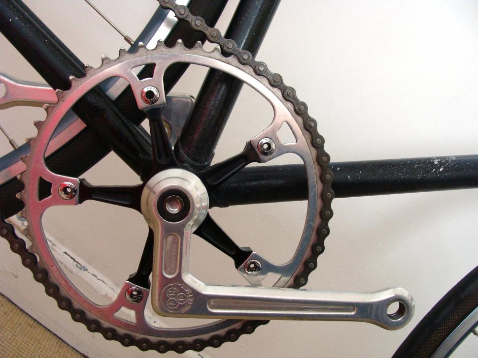

LOL - I just did a quick search for PMP cranks and they had the article with others too.
Anyway, I want a free pass because I remember seeing pictures of Ian Cammish riding PMP cranks in the 80s. In British cycling magazines. And thinking with my high school physics knowledge - “That makes no sense at all”.

No question, totally worthwhile to post here (I even considered pulling those very examples :wink: ) because they are quite relevant to the “reinventing the wheel” that these guys seem to be claiming. I haven’t dug in, but based on the comments here and my prior consideration on the topic, this new version is interesting, but more of the same snake oil.
