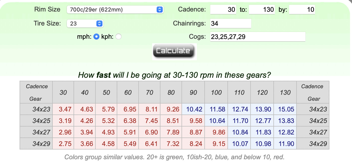

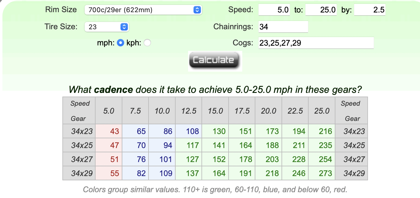

https://www.bikecalc.com/speed_at_cadence
This should help! Might need to flip through the options on the left to get the right page but I’ve found this very useful.
BikeCalc should work. Can choose different ways of displaying gears, cadence and speed.
Couple quick examples:
And
