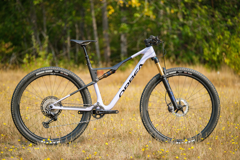

I am going to go look at that Oiz tonight. He has not registered the warranty and has the original receipt so I am basically getting a brand new bike at that price. The bottom bracket and wheels give me a bit of pause. Eddiegrinwald talking about the top fuel being ‘more bike’ gives me pause and some of the blow outs on cheaper stuff is concerning.
I am less stressed about a couple lbs of weight. I am okay buying wheels or swapping bars/stems/etc later. I do think its a pretty looking bike. It seems to be in the travel range davewh mentioned for CO and UT where i will certainly end up at various points. The brand new epic evo at $2400 in carbon is temping but physically harder to find for me.
Maybe I ask the other direction. Talk me out of the Orbea if i can get it for $1600 with a warranty. Why does this bike suck? Why am i going to regret it? Am i going to sell and upgrade to a 5k bike in a year anyway so i should just get something and start learning what works for me?
The bike doesn’t suck. From reviews I’ve read, it does well at what it’s designed for - which is closer to the XC race bike side of the spectrum than a general purpose trail bike.

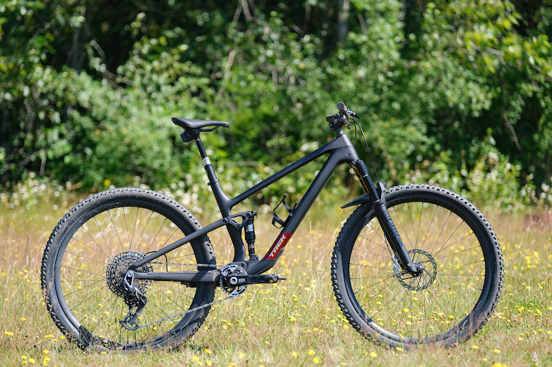

If you want a bike that will be more forgiving - either when you are a beginner, or as you gain experience and ride harder trails - a bike like the Trek Top Fuel would be a better fit.
Side note: I saw today that Trek announced the latest gen Top Fuel. Could mean earlier gens can be picked up cheaper.

Here’s a pretty glowing review that I watched so I know it’s a good bike https://youtu.be/g2abuBpBClA?si=H_4AdwC5HebKdKDa
It is very very similar to an epic evo, but I think people just aren’t as familiar w Orbea so epic evo is always first off the tongue. The only thing that gives me a little pause is the brakes, but that is just cause I’ve never tried them. I have SLX 2 piston which is a few steps above and I think they work amazing, but never tried the mt200.
Whether you sell or upgrade depends on the type of rider you end up being. But I think a 120/120 bike with a 67 deg head angle will perform really well almost everywhere you take it. More capable than my bike I have now and I don’t feel limited much at all.
I took a closer look at the bike for sale from the link above. There’s no dropper post on it. If you buy this bike, plan on buying a dropper post. That’ll add $200-300 or so.
One other factor - this bike has a suspension lockout lever right where the dropper post lever usually sits. You’ll need to buy a specific dropper lever that can be installed in a way that fits alongside the lockout lever.
This will mean having to get used to a suboptimal dropper lever placement. The review above posted by @nicholkid8 mentions this drawback also.

I don’t think anyone has said the bike sucks, quite the contrary. Honestly, don’t overinvest unless you know what you want/prefer. The Orbea will be a good basis for upgrades. Apart from the touch points, I’d get new brakes and a dropper post. Both really change a bike in tangible ways.

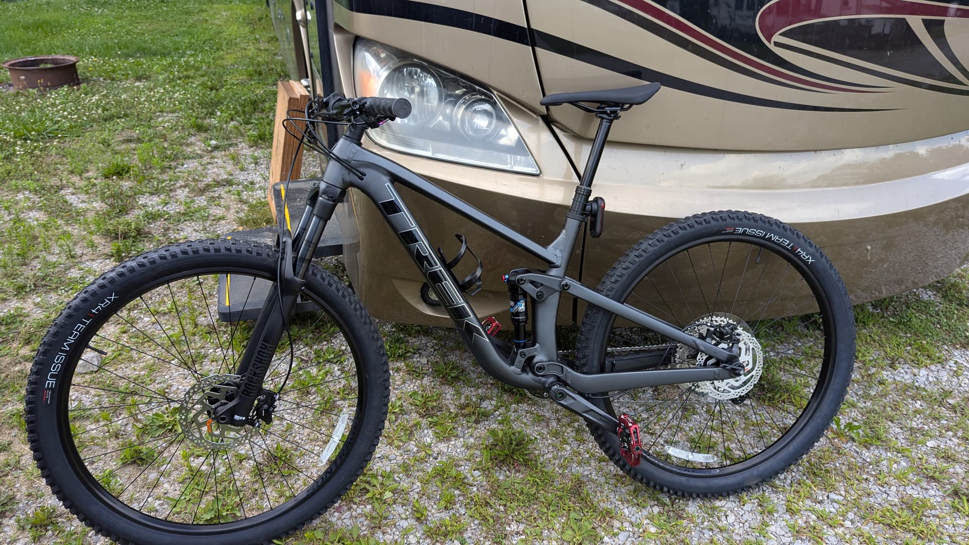

Thank you for the help everyone. I ended up going with the top fuel. It feels enormous, awkward, too much weight on my hands and I couldn’t be more excited to get used to it. Now I just need this left over hurricane to stop flooding all the trails.

Since that looks brand new, I’m guessing your shop already helped you set the suspension up, but that is a key thing that beginners usually overlook. Also tire pressure is really important and people tend to overinflate.
It might just be the picture angle, but that saddle looks pretty far forward. Pushing it back a bit will reduce the weight on your hands.
I’m far from an expert MTB rider, but the one mantra that always helps me is “heavy feet, light hands” when riding the MTB. It solves a lot of bad habits (at least for me).

What size did you end up getting?
Yeah, I did end up with new from a trek factor store so they helped me with fit and suspension setup and wrote down all the settings they went with. I have promised myself not to start screwing with it till I know something.
This seems like good advice. The saddle relative to the pedals is about the only part that feels right. The 1000s of hours of time on the road vs 2h on this will take a while to balance out.
I ended up with the medium and it still feels enormous. I did ride an ML and it was obvious even to me it was wrong. Too much reach and too low a saddle. With the dropper down I couldn’t really get back and low without catching the saddle.
The M size is likely the best fit for you given your height. How wide are the bars? Some of these bikes come with 800mm+ bars that usually need to be cut down to fit properly. This could be contributing to the bike feeling really big.
FWIW, I’m 5’9” and ride an M Trek Fuel with 760mm bars and that works very well for me.
That makes sense, I thought it was just habit but when I was on pavement yesterday my hands kept moving to spots over the brake pivot or even farther inboard. Way inside the grips. The ends of the bars felt comically wide.
