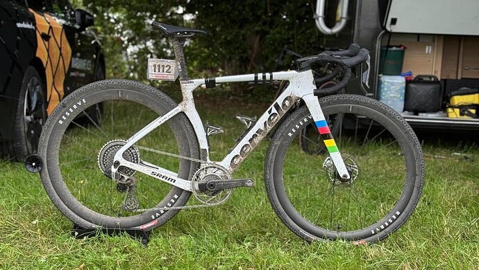

New Aspero inbound. Vos won on it this past weekend at UCI gravel in Aachen. Takes significant cues from the S5. Downtube storage and doesn’t look to be designed around MTB tires, but will see what official clearance is.
Very nice. I mean, not really as a gravel race bike but would love to run that as a road/allroad bike with slick 40’s or something.

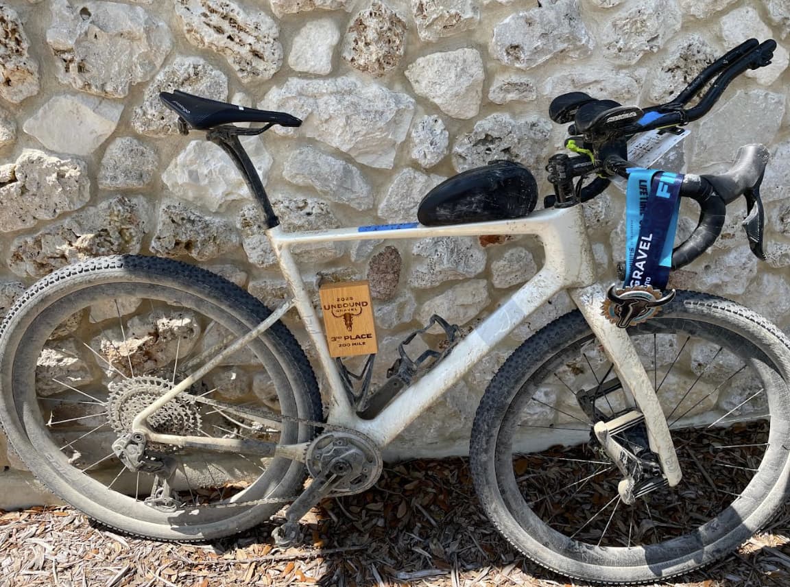

Another Lauf fan boy bike review post Unbound. The bike did everything right at Unbound. I didn’t really hold up my end of the deal and made a mechanical blunder early that cost me a bunch of time, but still managed to chase back for 3rd in AG. I couldn’t have been happier with the bike.
Ran 2.2 Race Kings and they were a big advantage for me early staying in the lead group. Even on the less selective sections, it was a constant fight for position early and the big tires made it easy to jump off the racing line into the rougher gravel or grass to make passes on the sides. And then where we got to the first double track at Kaw Reserve, same deal with making another track to pass people. Made the start much more manageable, made it to Eskride (~40 miles in) in the lead group where I was a couple groups back last year due to positioning. Almost 15 watts easier and 1mph faster to that point compared to last year with similar low wind conditions. I’d attribute most of that to me being able to move up on the sides when I wanted (rather than when it was strung out and going hard).
I had a mechanical at ~45 miles and ended up chasing solo most of the rest of the day. Bike was great on the chunk and solid on the flat/fast stuff, zero complaints. You are always hurting after a 11+ hours of gravel racing, but I felt much better than I did the last couple years and was able to push watts all the way to the end. I attribute most of the comfort to the larger tire volume, but the fork and seatpost help as well on the heavier stuff. I saw quite a few other Seiglas near the front of the race (when I was there early), I guess maybe I just notice them more now that I’m riding one. I also saw quite a few Mogs and a surprising number of new Allied Ables (not that many, but a lot for it being such a new bike). I’m sure the debate over tire size will rage on, but for me the bigger tires make sense on a course like Unbound. There are probably long stretches where a 50mm might roll faster, but for the sections that matter I found the bigger tires worth any penalty.
