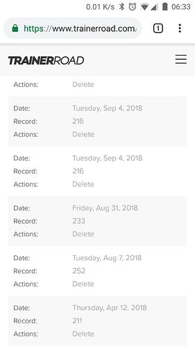

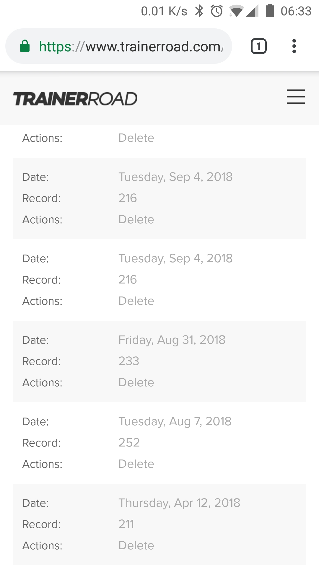

The high value was set for outdoor from a prompt on my Garmin. I can’t remember what prompted the 233… I think perhaps a ramp test. Then the 211 also comes from a ramp test.
I say perpetually because even this year I consider a reset due to surgery and a house move over the previous winter losing approx 3 months of bike time. This is the first ā€˜summer’ I haven’t suffered a major setback (even bringing the bike for our summer holiday) and it’s certainly demotivating to be no better off despite the best feeling summer in recent years.
