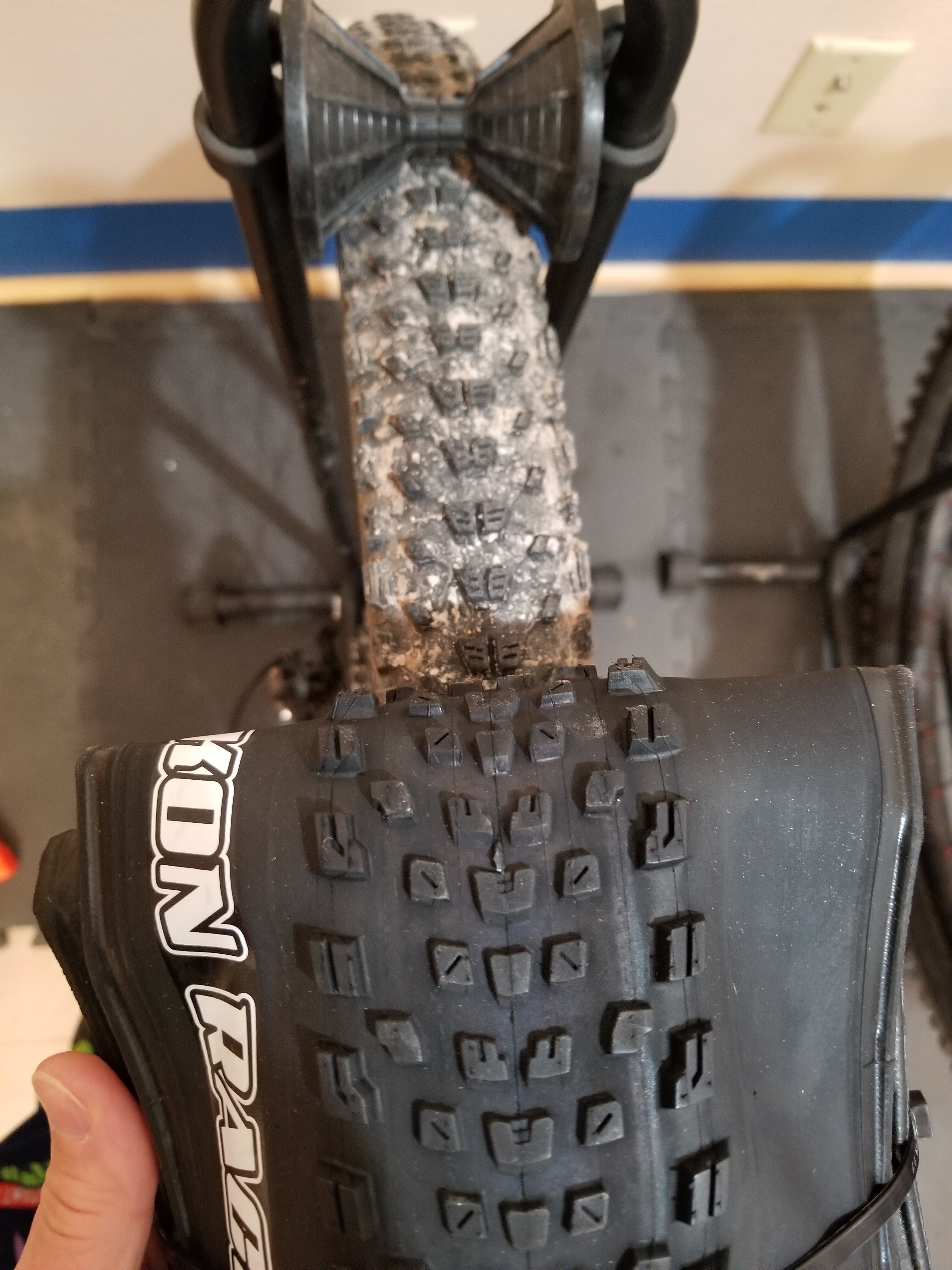

Just picked up some Rekon Race 2.4 120 tpi. Gonna run them on 25mm internal light bicycle carbon hoops on my Rocky Mountain Element. Currently running 2.35 Ardent race but I’m all about max volume and am curious to see how the rekon race handles.
I’m hesitant to run a semi slick in the front on some of the gnarlier trails around but after laying eyes on them I think they will be a great replacement for the ardent race!
