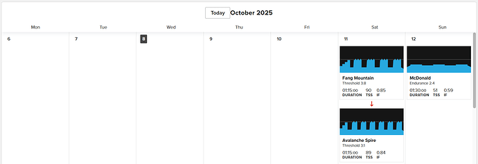

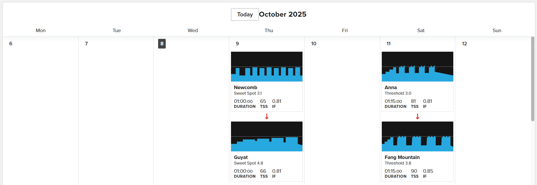

I’m seeing two rounds of adaptations now.
This one:
And this one:
I’m curious as to what prompted the second round.. :eyes:
Regardless, things look good.
