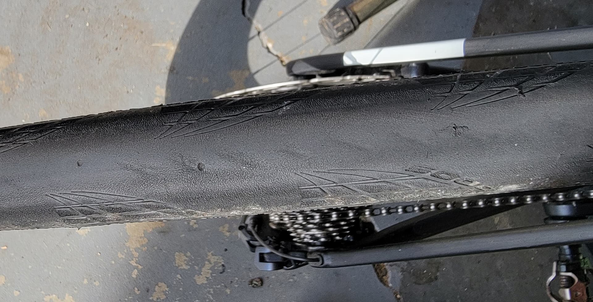

Quick question for the experts…my rear GP5000 TL is showing some wear but still holds air fine and the wear indicator dots are visible. There are diagonal marks on alot of the tread area (see pic). Is it time to change these? I was hoping to get through the end of the season with these tires but don’t want to risk anything. Thanks!!
I think I’d carry a spare tube, use it but keep an eye on it and order a spare that’s on hand for the day its starts spouting sealant too often.
