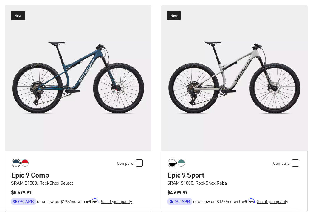

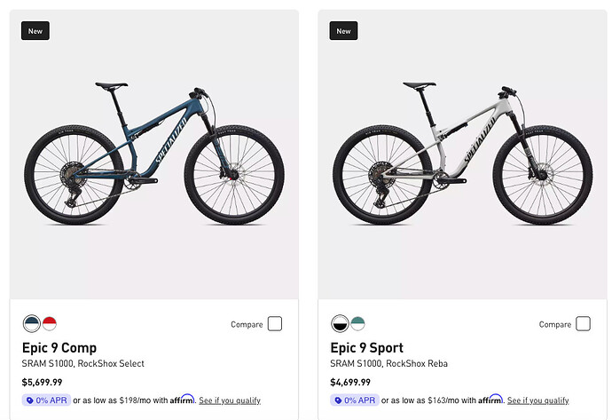

Specialized have added some more ‘entry/mid’ tier Epic 9 builds to the list, but still pricey considering the components. Still no frameset option for the non-Sworks frame. I wish they still had the 8 frameset available.
