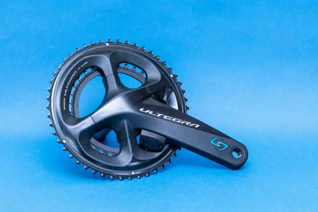

Are you sure the chain rings wouldn’t be compatible with a new crankset? I thought the differences were just cosmetic I.e. A previous generation ultegra chain ring would still fit a new ultegra crankset just might not look quite as slick.
The issue has to do with the chain line. I forget the numbers, but they differ around 1mm or so, but that is not something I know for a precise value without more research. No matter the actual number, Shimano is using the 12-speed based cranks for the 11-speed solution requires ā€œspecialā€ chainrings from Shimano to offer the replacements.
I have not heard anyone question the future issue of possible chainring replacement since what they are making for this fix is not like either 11-s or 12-s options that will be readily available for future needs. And then this example shows the future case of issues for anyone heading to non-Shimano rings for any reason. In a way, Shimano just created a 3rd chainring standard… and we know bike riders love new ā€˜standards’ :wink:

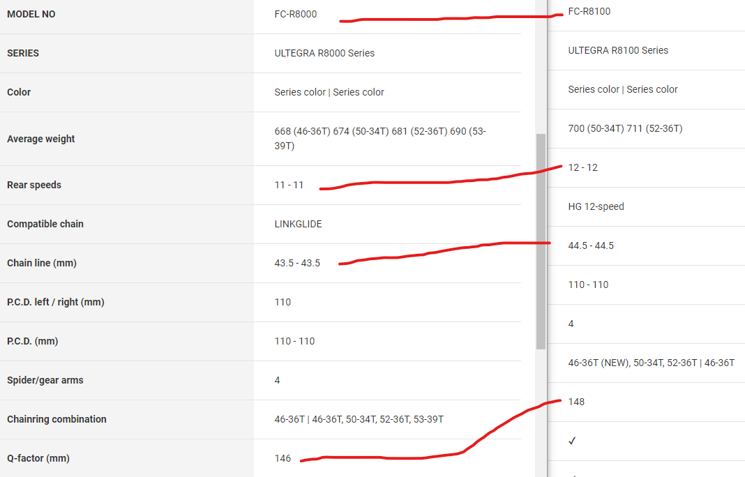

ETA: Quick specs comparison between stock 11-s & 12-s Ultegra
This is still up to debate to me, I thought the 4-bolt spider pattern changed slightly. Regardless, my chainrings probably wouldnt work as they are cut to fit the 9100 cranks
Isn’t 1mm of chainline difference just a minor tweak to the FD? ā€œSpecialā€ chainrings sounds like a terrible idea!

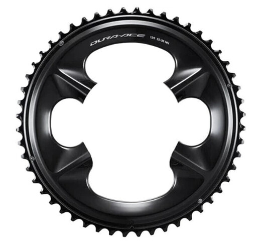

Dura Ace 9200 chain ring above. Looks like there are now 2 junctions (the bottom 2) where it curves away from the centre instead of 1. So I would guess that a 12 speed chainring will fit on an 11 speed crankset but that the 2nd curved junction won’t match up nicely. And an 11 speed chainring wouldn’t fit on a 12 speed crankset unless you carved an extra piece off one of the junctions to make it fit.

Where did you find those specs?
I’d be switching from an older ultregra 6800 - is that just the same as a R8000?
EDIT:
Found it… looks like the chainline on the 6800 is also 43.5 and the Q-factor is slightly larger at 146.6
