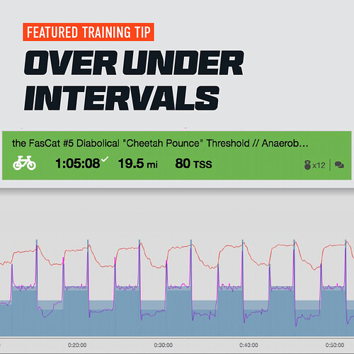

My coach is with FasCat, and they have all sorts of interesting variations on over-unders. Here are a few examples:
Had one on my calendar last week that made me a little nervous, similar but different from yours above (a little harder above threshold, slightly easier below threshold). Seemed possible to complete given my recent efforts, but I caught a flu bug and ended up taking last week off. This week it looks like he put a more tame ‘castle’ :metal: (put that into an interval) on my calendar.
More like, “Hold my beer …”
I adapted my over unders this year to be more race specific as well, attack and repeat, specifically. It’s a similar protocol to one of FasCat’s suggestions but goal is still lactate shuttle - repeating 5min power followed by 92-94% for 3-4x as long. E.g. 1min at 5min power - 3 min at 92%, five rounds per set, two sets.
I found it good early season race prep, and it keeps highish power sharp during a threshold block.
This is fantastic. We are finding that the more race specific over/unders are highly beneficial; especially toward athletes that are well trained and have grown accustomed to traditional 2:1 (as an example) over/unders. Our current questions are around what is the best way to train immediately after a round of race specific attacking over/unders. Is it SS? Or is the metabolic cost not worth it? Is it Z2? Or does higher intensity yield better lactate buffering? It’s really interesting … unfortunately Covid has really affected our lab time so it’s all a bit up in the air in terms of convulsions. Only themes have emerged at the moment but inconclusive themes and not defensible without more testing which is frustrating!
