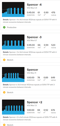

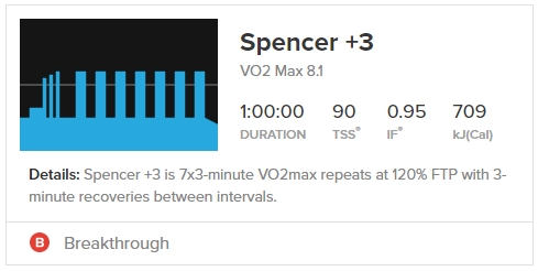

This is what I was thinking would happen. 7x3min at 120% is most likely not a level 5 VO2 workout. I would suspect it’s on the higher end of things rather than the middle in terms of that energy system. What level is Spencer +2? That one is always my major stumbling block in the progression for me.
  • BINGO!!!
OMG! No wonder Spencer slays me every time! That’s such a high level.
I had the exact same thought as I was looking at it!

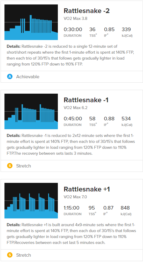

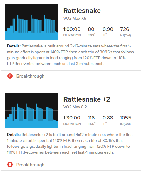

Last question…Rattlesnake variants :pray::pray:

Interesting that Spencer -4 is so much higher than Breasted. Struggle 4x3min and shoot through the ranks…
I already see the discussionā€¦ā€With VO2max I’m training a state and no power…13x30/15 gives me much more time at HR>90% HRpeak than 4x3min…why is it scored so lowā€¦ā€

I have never seen any of those Rattlesnake workouts before on my calendar…I hope that trend continues :slight_smile:
