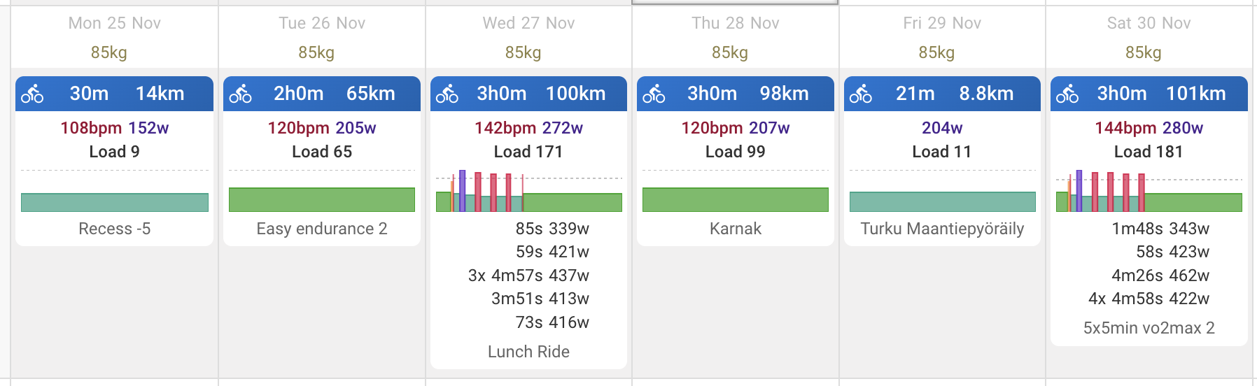

I have absolutely no idea how you guys get it to so high. I ride consistent 12-14h weeks with 1-2 tough interval days, including sweetspot rides of 1.5-2h of TiZ, vo2max rides of 5x5min etc. But no matter, it seems to be enough for me in any case :smiley:
Its been a year of getting back to fitness for me after a hip replacement in January. So starting with a fitness score of 1 :rofl:
Mmmm. This strange, something doesn’t add up. Maybe your set FTP is too high relative to the actual power in your rides?
My ftp of 360 is set from a long form test (Kolie style). I also just did 2h of sweetspot at 327w, so my TTE is good. If anything, my ftp is probably a bit higher now that I have been doing vo2max work. So that would make ctl even lower.
It’s just that I do endurance training “too easy” for these models, these days usually at around 200-215W or an IF of 55-59. It works for me, I progress well, and I know I could not do endurance riding any harder or I would burn out.
100%…my first reaction was the same as yours - something is off with FTP. At those hours and with that weekly structure, @visa.k visa should be ~100 CTL.
Here’s a couple recent training weeks.
I don’t think I have ever even hit 700TSS in a week so I dunno how I would get 100 ctl, lol. 450-600 is sustainable but then you take one easier week and CTL drops again.
But again, I don’t really care about this – my 5min power and FTP have steadily risen for a long time and the training seems to work well.
I think you missed our point… if your FTP is set incorrectly, then your resulting TSS and CTL numbers are flawed. So it would make sense then that you have never hit 700 TSS in a week.
Well, considering that I clearly said that I have tested my FTP with a long form Kolie Moore test, then I don’t know why it would be inaccurate. Last winter I first tested 340W for 40min, then after vo2max work I worked up to 60 min at 350W, and then this fall I did 360W for 40min. Now I am doing vo2max work and expect my FTP to rise to 370-375W afterwards. This would only lower my TSS and CTL, not raise it.
